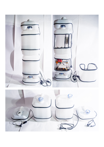

This is an enclosure for open source 3d printers that you can easily make yourself for a low cost. This is to provide a stable working environment outside of the office or workshop.
The enclosure has been designed to securely hold and protect your printer inside an insulated environment. It is has a ventillation system which actively removes dust and moisture to below 70% relative humidity aswell as maintaining a stable working temperature of ~ 27°C.
Currently it holds a modified printbot so that the entire bot can fit inside a 280/280/280 space (the enclosure).

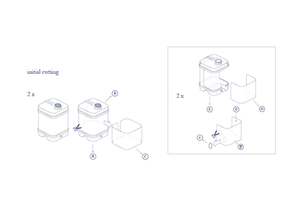

Step 2: Initial Cuts
Cuts are made to 4 X 25litre container ready for further construction. All parts of the containers are used to reduce overall waste and efficiently use the material available.
A & B - become part of ventillation system
Y x 6 - become a washer for ventillation system
E - become your 3d printer and filament holder

Step 7: Slide It All Together
Using the 25mm lengths of clear tubing, slide all your parts together to create a friction fit which holds everything to make a complete system. Your mini 3d printer is now ready to venture out into the wild!
