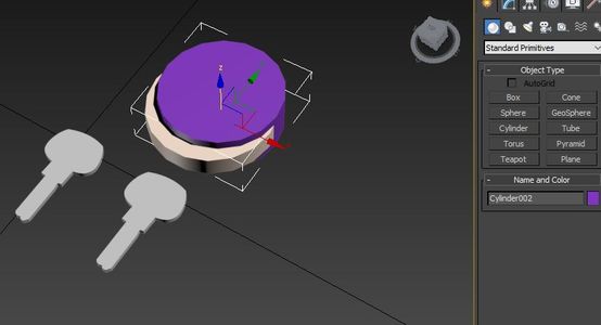

Next, clone your 3d key and and make sure you chose copy not instan look at the picture 2, now you have 2 key, create 2 cilinder and one make bigger and heigth look at picture 4, klick geometri and chage dte standart object with compount object clik object little cylinder and click pro boolean and clik the bigger cylinder so the little cylinder will be truncated with the bigger, now move the object to your copy key look at pictute 9, follow the last step for cut the key, create a box for delete the rest of the key are not truncated. so now you have a head key. pic 13, move the head key to the master key, make the head more bigger than key, make sure the head master key cover by head key give space 2 mm from all sides of the key, next klick object head key klick pro boolean and clik the key pic16, now you have a cover head key,
