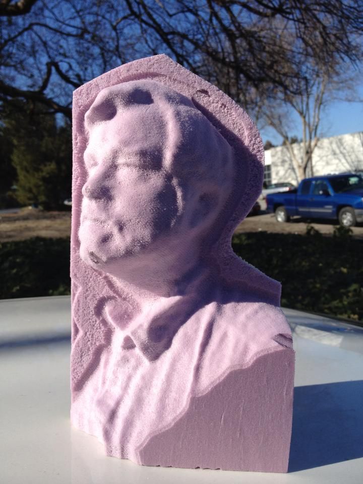

Step 4: Cut on the ShopBot
Running the ShopBot requires training, and I'm not going to tell you how to do it here. I will give you some tips I've learned.
Material
I used pink foam insulation because it is dense, soft, and cheap! I bought a 4x8 sheet of Owens Corning Fomular 150, 2 inches thick. The material comes pre-scored to fit between studs, so if one dimension of your model is larger than 16-inches this won't work. To cut the insulation I scored it on both sides with a utility knife and then snapped it. Easy as can be.
I used a few small dabs of hot glue to affix my material to a sacrificial strip of 1/8 plywood. (Don't know why you need a sacrificial strip? Take the ShopBot training class.) If you want to later remove your piece from the plywood, then use little dabs of glue.
Vacuum skirt
You'll notice in the photos that the normal vacuum skirt is removed. My first attempt (second if you count the failed BabyBot work) found that the up-down motion of the spindle would dig the skirt into the material and wrecked it. This material is too soft for a stiff skirt. I loosened the vacuum skirt, raised the spindle and the skirt fell out.
Without the skirt I had to chase the spindle around with a handheld shop vac to keep the table clean.
Setting 0, 0
I've had problems with the ShopBot losing its position in the middle of a cut and ruining my piece. Mostly this has happened with the table top size BabyBot, but I worry about it all the time now. My approach is to draw a dot for 0,0 on the vacuum table and set the SB to 0,0 there. Then I raise the spindle and position it at the lower left corner of my material. I note the coordinates on the SB console and write them down. Then I set 0,0 to where the spindle is located. This way if the SB loses position I can move back to the table mark for 0,0 then move to the noted offset and rezero there.
Air Pass
I set the Z 0 to the top of the material so that the cuts will all be above it. I bring in my first part file (the one with the A in the name) and do a cut. This air pass lets me see that the material is positioned correctly and allows the spindle to warm up. I let it air cut for two minutes.
Load the Bit
Look at your first cut file, the one with the A in it. Enter Preview mode on the SB control software and make sure it looks like what you expect. Now remember that the file name tells you this is a 0.5 end mill bit.
When you load the bit you need to measure the distance from the tip of the bit to the collet. If you cut any deeper than that the collet will rub the work piece and you risk damage to the piece and the collet. (see the image) The file name reminds us that we need 1.67 inches clear. If you don't feel the bit can safely extend this far, then you have to go back to V-Carve 3d and slice your model into pieces.
The Real Z
I know from my file name that Z 0 is at the bottom of the piece so I turn on the table vacuum (remember that the table is only flat with the vacuum turned on) and set Z 0 at the top of my sacrificial piece.
The Cuts
Now I let the ShopBot run and my model slowly appears out of the solid block. It is really something to watch.
I set the 0.5 end mill to 8,000 rpm and 2 ips cut speed. This seemed to work well.
The 0.25 end mill was running at 10,000 rpm and 6 ips. I found it was starting to tear the material just a little bit. I used "Shift <" on the ShopBot to lower the cut speed to 3 ips and the problem went away.

Step 5: Done!
I now have a 9x12 scale model of Edgewood park!
What have I learned?
While the steep canyons in the front of the model photo look great, the gently sloping planes of the back side still show some lightly bumpy artifacts from my original layered model. To the unknowing it looks like natural terrain variation, but I know that those "natural" humps occur at the exact spot of the layered model. And it is obvious that if the original layered model was not accurate, then this finished model will not be.
I found that the material is fabulous to work with. It is very cheap and easy to cut. However it is also soft. Just bumping the finished model against a solid object will mar it. Even a hard finger press leaves a mark. You can see a slight team on the right hand edge of the model.
