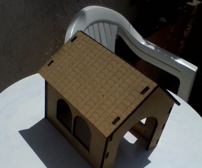

Step 3: Cutting 3d Printer
this is our laser cutter it is DIY project
we have build this machine as you can see from design :P
it is 150w co2 laser
