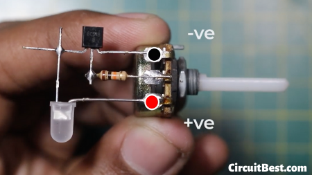

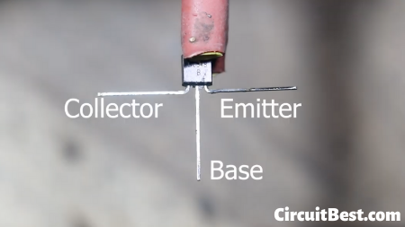

Step 1:
First, you will want an NPN Transistor. Here I am the usage of BC548 Transistor. You can also use every other NPN Transistor as well. I bent the three Legs of the Transistor. Then I even have Pre-tin the wires for higher soldering. In the picture, you can see the Pin output.

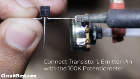

Step 2:
Now you will need a 100k Potentiometer. Connect the Transistor’s Emitter Pin with the Potentiometer nook Pin.

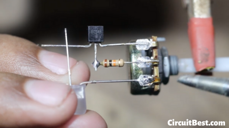

Step 3:
Connect LED with the circuit. Connect LED +ve with Potentiometer. And join LED -ve with the collector of the Transistor.

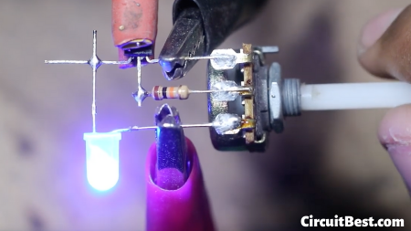

Step 4:
Here are the connection points of the circuit. The voltage might be according to the load. Here I will connect 3v LED so I decided to hook up with 3.7v 18650 Battery. if you have 12v masses then you can connect 12v as well.
Step 5:
So, Lets Test the LED Dimmer Circuit.
