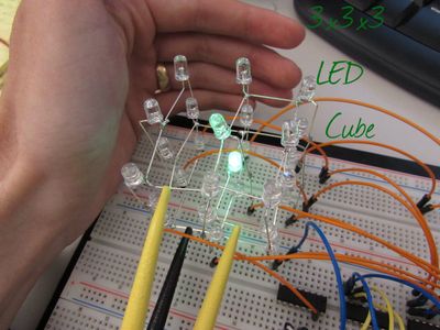

So, this leaves us with the option of creating a two dimensional sheet of LED's. What we will be doing, in essense, is creating a fence of LED's which will snake back and forth into a cube shape. All nine of the fence posts (for the 3x3x3 cube) will be the anodes and the three horizontal fence bars will be the cathode layers. Check out the above picture for a visual look of what the cube would look like.
As a clarifying point, the anode posts and the cathode layers are not connected; they just are the same color and visually look like they are touching when, in fact, they are not touching.

Although we have now completed our proof of concept, our prototype is simply not the same thing as an actual LED cube. In terms of how to solder the LEDs together in the cube shape, I recommend pre-bending all of your LEDs that you have in a style similar to the picture shown with the anode pointing down and the cathode pointing out.
I would find some sort of way to get the first snaking layer of LEDs soldered together by their cathodes. You will notice that the 9th LED's cathode will then be sticking out to the side; feel free to solder this to a cathode of one of the other LEDs in that layer to help provide some structural integrity.
I would then take the next set of nine LEDs and solder their anodes to the anode of the LED beneath them and solder the cathodes of that layer together as well and then do the same thing for the third set of LEDs. After you are finished, you should get something similar to what you see in the second picture, taking into consideration that I am not the greatest solder'er in the world.
