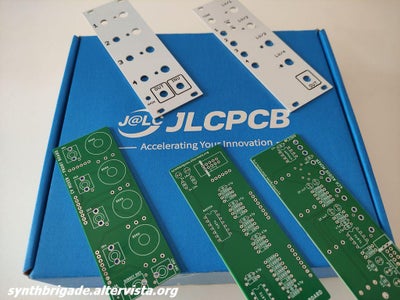

I will share with you Gerbers to have modules realized by pro manufacturers and help you have two fundamental pieces of a synthesizer at the smallest price possible.
Yes, you will have a lot of fun in the process, so give DIY a try! ;)

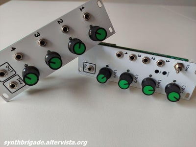

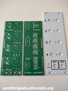

We are dealing with two mixer modules here, designed with very different applications in mind: one for audio, the other for control voltages.
The audio mixer circuit is simpler, use a small amount of components and I was able to lay the whole circuit down onto a single PCB (main board).
The full audio mixer module calls for the aforementioned main board and a front panel aluminum PCB with no components at all.
The CV mixer module is instead made of three PCBs: main board (the one with main circuitry), front board (the one hosting potentiometers and jacks) and an alumium front panel.
Again, the CV mixer module front panel has no components.

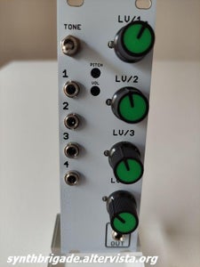

Step 2: Audio Mixer Circuit and Module Design
This project follows a previous 4 channels mixer module. The time had come to focus it more to its final application (audio mix) and remove some unecessary feature.
Improvements
First: no variable gain. Eurorack oscillators signal is HOT and needs attenuation before hitting external hardware. Going higher than unity gain in the final stage makes no sense, so we are allowed to save some good amount of panel space by omitting a dedicated gain potentiometer.
Second: no inverted output. To human hears, direct and inverted audio signals are perceived the same. The most basic audio mixer could use a single op-amp in inverting configuration and you won't notice.
Built-In Reference Tone
A feature I always use with my analog oscillators, the built-in digital reference tone for tuning is something I could not live without.
This feature was already present in the previous mixer version, but it is here upgraded by the addiction of on-the-fly control over the pitch and an RC filter in it's output stage with a roll-off frequency of just under 6kHz.
The sketch I have written for the reference tone is also brand new, with a direct square wave generation instead of the adoption of the basic "tune" Arduino function. This made the wave's tuning control way more effective, without the audio glitches the function was generating when moving between semitones.
Reference tone's pitch and volume can be set directly from the front panel through two dedicated potentiometers. These are two trimmers firmly soldered on the PCB, but made acessible through two holes on the front panel.
Circuit
This new four (monaural) channel audio mixer module's circuit is based on a very simple but effective design by Doepfer.
The circuit is built around a single dual op-amp in single package. I used common TL072, but one could use any other, pin-compatile op-amp of choice.
A human ear characteristic is it not being sensible to audio DC bias. Anyway, when two (or more) waves are mixed, the resultant wave is actually affected by relative bias. This is why every input of this mixer has an AC coupling capacitor following its voltage divider.
If the audio source is well known to be already AC coupled, one could omit these and replace them with jumpers.
>>HERE<< is a Falstad's circuit simulation of this mixer.
Module Design
The mixer circuit is made of only few components, and I dedicated due efforts to lay the circuit down onto a single PCB (plus the front panel) instead of two stacked PCBs.
All components values are silkscreened on the PCB to make assembly easier (I hate reference sheets).
There are no exhotic components, nor special care is in the need in components selection with the exception of potentiometers.
In the first iteration of the mixer I used linear pots because cheaper and easier to find than logaritmic. Human perception of volume follows a logaritmic law, instead, so in this more "focused to audio" mixer module I had to adopt logaritmic potentiometers by default.
Potentiometers are wired in voltage divider configuration, so even if the silkscreen shows 50K ohm potentiometers for input level, but you could use 100K ohm pots in case you have those laying around.
The module calls for +12V, -12V and +5V. The 5V line is in the need for the digital tone generator, so you could omit it in case the reference tone is of no use for you.
It's 3U tall, 8HP wide and made of only two boards instead of three (front panel and main board).
Not bad, if you ask me!

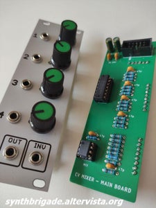

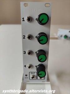

Step 3: CV Mixer Circuit and Module Design
CV Mixer Challenges
When dealing with control voltages, you often don't actually need a perfect tracking of the incoming voltage. Think i.e. to the common CVs from your keyboard (velocity, tracking, aftertouch): they could be lowened to some extent at mixer out and you won't even notice.
Different is the case when you want to mix voltages for pitch control. A classical example is the application of some vibrato, where you add a certan amount of "oscillation" to your pitch voltage.
Human perception of pitch is extremely accurate and requires closely matched and/or trimmable components, so designing such a mixer calls for some special precautions.

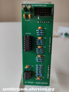

Circuit
First of all, we adopt a buffering stage at the input of any of the 4 channels as to not load down the output of whatever module is carrying the pitch.
The buffer is here made of a quad op-amp (TL074) in voltage follower configuration.
The buffered signals from each input are then fed to an attenuation stage before hitting the mixing stage of the circuit.
Attenuation is simply made with linear potentiometers in voltage divider configuration.
The mixing stage is similar to the audio mixer's one we have seen in the previous Step, but with "pure" unity gain in sight.
A gain trimmer is a good way to compensate for losses from the previous circuit sectors. This is placed in series with the appropriate feedback resistor dimensioned for a teoretical unity gain.
I adopted a multi-turn trimmer for fine gain control, which had the welcome side-effect of keeping the module width way smaller than a potentiometer would allow.
The use of 1K ohm current limiting resistors at the direct and inverted output placed inside the feedback loop is a further care to limit the voltage drop at the output stage.
The 1K Ohm resistors serve not only as short-circuit protection for op-amps (every time you patch, the tip of the mixer output is shorted to the grounded sleeve of a jack), but also protects it from static charge damage, for example when a cable is inserted one side only.
This module calls for +12V and -12V. It's 3U tall and 8HP wide, like the previous mixer.
I layed down a Falstad simulation of the circuit you can toy with >>HERE<<.
