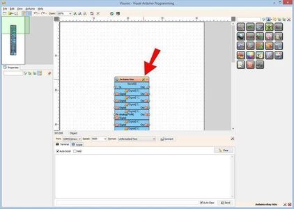

Start Visuino as shown in the first picture Click on the "Tools" button on the Arduino component (Picture 1) in Visuino When the dialog appears, select "Arduino UNO" as shown on Picture 2

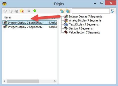

  • Double click on "Display1" component and in the "Digits" window
    • drag "Integer Display 7 Segments" to the left side
    • On the left side of the "Digits" window select "Integer Display 7 Segments1" and in the properties window set "Count Digits" to 2
    • drag another "Integer Display 7 Segments" to the left side
    • On the left side of the "Digits" window select "Integer Display 7 Segments2" and in the properties window set "Count Digits" to 2 and "Leading Zeroes" to True

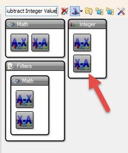

  • Select "SubtractValue1" and in the properties window select Value and click on the Pin Icon and select "Integer SinkPin"

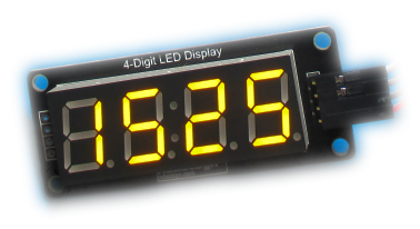

If you power the Arduino module the LED Display will start to Count Down.
