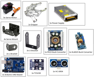

Step 1: List of Parts Needed
Note: the link to these parts i bought is from local online shopping website in Indonesia (Tokopedia) and some bought from local retail stores. if you want to find the parts at region you're living my tips is search with the keyword of the parts i list then match the images of parts, hope exact same part i used available at your region local stores (online or retail), if not you need improvised a bit.
  1. Wood board 50x50cm.
    This is optional parts, if you wish to place your robot and component on your desktop is also fine.
  2. Arduino UNO Board.
    This part should be available everywhere you live.
  3. Gripper Module.
  4. Robot chassis.
    Consist of: L-Bracket, U-Bracket, Universal Servo Mount.
  5. 3x TowerPro MG996R Servo Motor (clone version).
    Make sure buy 180 degree servo, not continuous (360 degree) version.
  6. 2x JX PDI-6221MG-180 Servo Motor.
  7. Optional metal servo disk.
    This is accessories component for servo shaft for joint or mounting to other component. when you buy servo motor usually you get included component but made of plastic, so maybe to save budget just use the included mount, the metal version are aftermarket accessories.
  8. 12V 10A AC-DC Power Supply.
    Don't forget 3 wire cable and male plug socket.
  9. HC-SR04 Ultrasonic Sensor.
  10. TCS230 Color Sensor.
  11. PR15 DC to DC Step Down Buck Converter 12A 100W.
    This part is to step down voltage of power supply to 6.5V to supply power for servos and Arduino board.
  12. XL4015 DC to DC Step Down Buck Converter 5A.
    This part is to step down voltage of power supply to 5V to supply power for sensors.
  13. Block of wood, or other object for demonstration (at least 3 piece, Blue, Green, and Red) as shown on the YT video.
  14. Bolt, nut, and washer.
    I even don't know how much bolt, nut, and washer used for this project, so its self adapted
  15. Jumper cables.
    To connect all the components

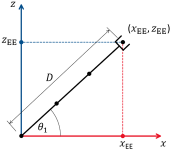

Step 4: The Inverse Kinematics (Part 1)
Given angle value each joint of group of bodies or mechanical system then calculated to give output of position coordinates where the tip of the system are expected is called 'Forward Kinematics'. Forward kinematics of course sounds not suitable to operate a robotic system, we want the opposites, determined the path, or trajectory of robot end effector where to move, then calculate how much angle each joint should rotate. because when programming a robot we need to send 'signal' from controller board to the actuator, the signal contain value of information how much angle servo motor rotate that drive the robot joints, hence why we need Inverse Kinematic.
In this project, the inverse kinematic equation will use a geometric method to determine the joint angles of the robot arm to reach desired end effector position. For reducing the complexity, we reduce the problem from 3D to 2D point of view. Now, lets assume we look at the robot arm from above, which represent plane (x, z). To make the gripper (end effector) reach desired coordinate position the first joint should rotate at variable declared as "Theta 1", beside the first joint rotation, the arm need to span to make end effector reach desired coordinate position. Let's symbolize variable how far the arm need to span as "D". Calculation for Theta 1 and D is shown on picture above.

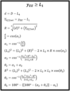

In the previous section we have implemented formula from geometric principle which can be used to calculate the rotation angle of joint 1 (Theta 1), now we are analyzing another 2D viewpoint to determine the equation to find the other three joint angles (Theta 2, Theta 3, and Theta 4). In short, how much angle joint 2, 3, and 4 needed to rotate to make the arm form span from length that calculated before (D).
Calculation to find Theta 2 (joint 2 rotation angle) and Theta 4 (joint 4 rotation angle) when position of gripper (end effector) lower than joint 2 position in y axis direction a bit require different formula than if end effector position higher than joint 2 position.
This inverse kinematic formula only for to make link 4 (L4) parallel to the ground/surface, but since this robot is 4 Degree of Freedom (4DoF) so there is flexibility to not only determined position where its end effector should move/reach but also the orientation of the end effector, but it require different formula.

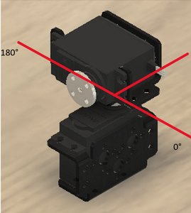

An 180 degree servo motor mean it can only rotate from 0 degree position to 180 degree position, so when you install the shaft mount disk thingy (silver or black round parts on the picture) make sure it is at calibrated position. Let say when you at process to install joint 2 servo mount on the joint 1 servo disk that you already know at what degree joint 1 servo at.
Rotation direction of servo motor shaft usually counter clockwise from 0 to 180 degree, that if from perspective when you look at the shaft, but when you look from the opposite sides from 0 to 180 is clockwise, so pay attention of shaft rotation direction relative to where the servo installed.
