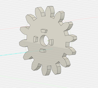

Firstly was the "dogs" on the gears. This is a rather simple, but it allows for a much more compact design.

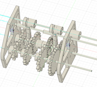

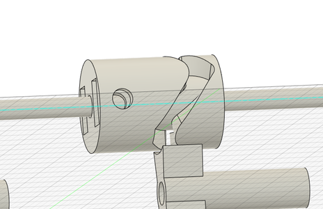

The trouble I had in the initial design was getting linear motion to move the selectors. Indeterminate Design used a pin which is moved by a rotating piece (this is shown in the image above). A benefit of this solution was that the whole transmission can function on only one stepper motor. Each the pins and mover component aligned are designed so that there is a gear every 90 degrees.
Hence, I ended up with my current design which is shown above.

So currently, the transmission does not actually work properly. There are some issues with the shifting mechanism which isn't very smooth and reliable. Also, I feel that I can make it a lot more compact. Hence, I honestly would not recommend that you actually create this project. Instead, I have posted this primarily for inspiration.
I am still working on this project, so if you would like to make a transmission for your own project, hopefully in the next few months I will update this Instructable with a perfectly functional version. When I update the Instructable, I will also add steps to help anyone make the transmission themselves. I have left the Fusion360 file below, but it also has a few weird things going on.
