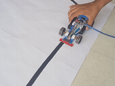

Step 1: The Idea
The basic idea is to make the build look more like a F1 car with as possible as low ground clearance.
The chassis
The chassis will be made up of two major parts - one rear and other front. Both of them will be connected in the middle portion using nuts and bolts. A rear wing will be attached to give the build a final touch.
IR sensors
For the robot to know it's position on the track we will use IR sensors. The more IR sensors we have the more precisely we can know the position. Keeping this in mind we will use QTR-8RC sensor - a array of 8 IR sensors.
The QTR sensor will be installed to the front of the build resembling front wing of an F1 car.

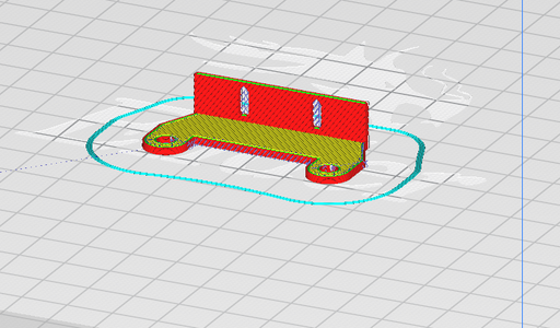

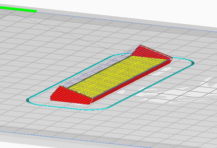

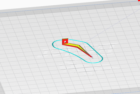

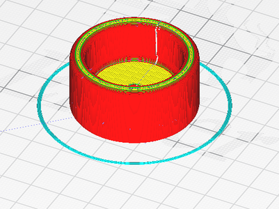

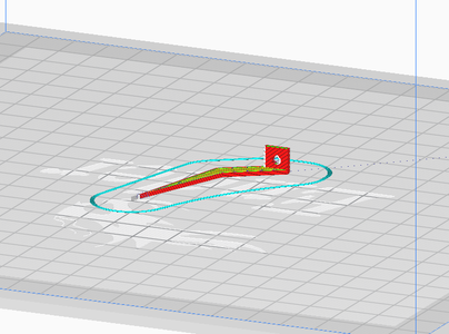

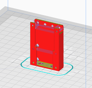

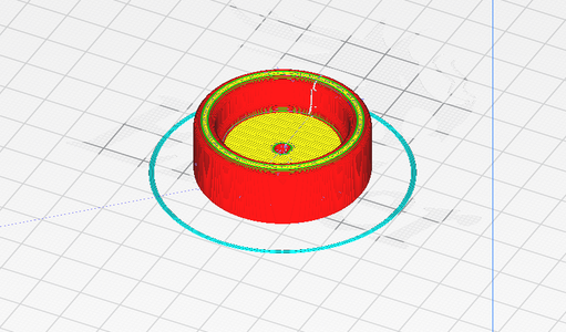

Step 4: Printing 3D Parts
I have printed the parts in PLA and so you can with 0.4mm nozzle, 0.2mm layer height and 20% infill without any custom settings.
As of color the wheels are printed in black and for the chassis you can go with any color you like.
The parts were designed in Fusion 360.

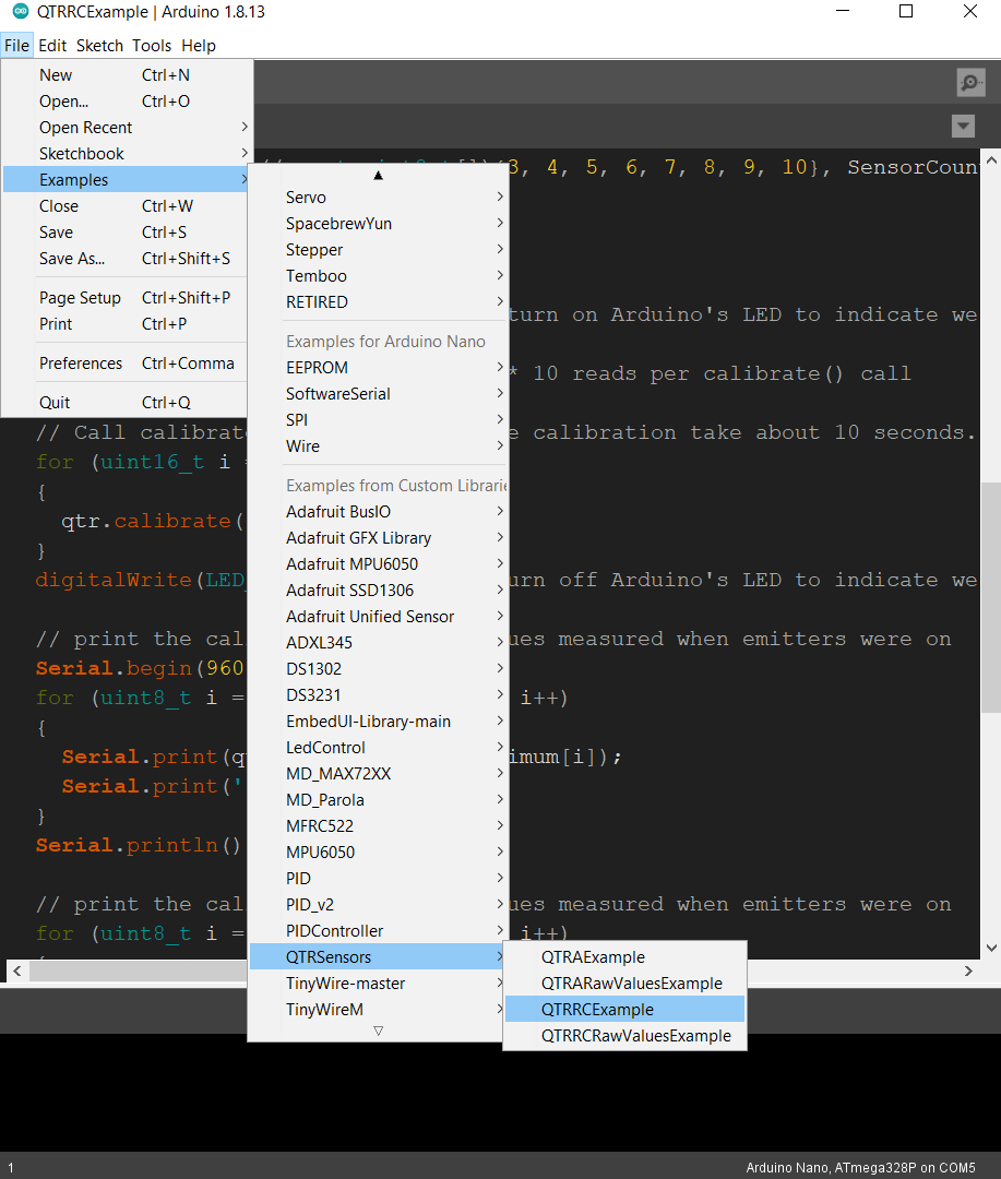

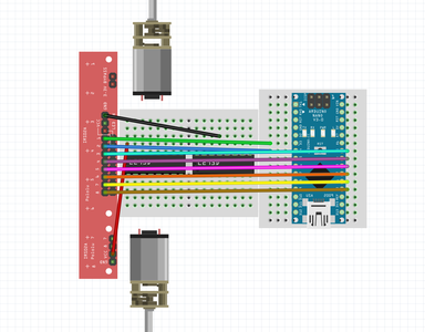

Step 5: Preparing QTR-8RC Sensor
We will utilize almost every pin on the module except IR which is used to turn on and off the IR LEDs if necessary. The pin is pull high internally so even if we don't connect it will be ok.
  • Solder male pin headers to module.
  • Ensure the long legs are on the side of PCB where no component is present and the solder joint are soldered on the side where components are present.

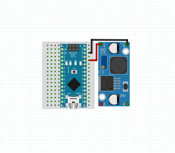

Step 23: Powering Micro Controller
Arduino Nano will be powered using buck converter and as the the voltage is step down by buck converter we will connect its output to 5V pin of Nano rather than Vin of Nano.
  • Take a single strand wire and cut to appropriate length
  • Then solder the one end to buck converter and bend other end and insert in breadboard.
Connections:
____Buck converter__Arduino Nano__
  • ___OUT+_________ 5V________
  • ___OUT-_________ GND ______

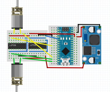

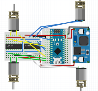

Step 24: Connecting Front Motor Drivers
All the connections were made using single strand wire except the power for motors to save red color wire for future use.
Note: The connections illustrated above and mentioned below are ones to be followed and not the ones shown in picture as they were changed to ease out the code in latter of the build.
Connections:
L293d-1 is the one closest to front motors
____Nano___L293d-1___L293d-2____
  • _ 5V____pin 16_____ pin 16_____
  • _GND___pin 4_____ pin 4-12____ (pin 4,5,12,13 of L293d are connected to each other internally)
  • _ D2___ pin 1, 9____ pin 1, 9____
  • _D12 ___pin 7________________
  • _D11 ___pin 2________________
  • _D10___pin 10 _______________
  • _D5____pin 15 _______________
  • _______pin 8______pin 8 ____to + of battery pack taken through IN+ of buck converter
Step 25: Connecting Rear Motors
The connection for rear motor were also made using single strand wires.
Connections:
____Nano____L293d-1____L293d-2___
  • _D9_________________pin 2 ____
  • _D8_________________pin 7 ____
  • _D7_________________pin 10 ___
  • _D6_________________pin 15 ___
  • pin 3 to closet pin to arduino of left motor when seen from behind
  • pin 6 to farthest pin to arduino of left motor
  • pin 11 to closer pin to arduino of right motor
  • pin 14 to farthest in to arduino of right motor
Still confused?
No worries head on to next step it will help in debugging.
Step 26: Testing Motor Connections

After 2 seconds of powering up the wheels should start rotating.
Place the robot on ground, if all the connections were made perfectly then the robot should move forward for about 2 seconds rotate clockwise and then again move forward in whichever direction it is pointing.
Points for debugging:
  • If the wheels rotate in the opposite direction than expected, flip the connections to the motors.

As the QTR sensor has male headers and the breadboard require female ones we need male to female jumper wire to connect QTR sensor to Nano but the length of the premade jumpers is not customizable, so I have cut the female part of jumper to required length and then soldered the open end to male pin headers.
Connections:
____QTR sensor____Nano__
  • _VCC__________5V ___
  • _GND________ GND___
  • _D1___________D3____
  • _D2___________D4____
  • _D3___________A5____
  • _D4___________A4____
  • _D5___________A3____
  • _D6___________A2____
  • _D7___________A1____
  • _D8___________A0____
There is no need to connect IR pin to any as the pin internally connected to VCC.

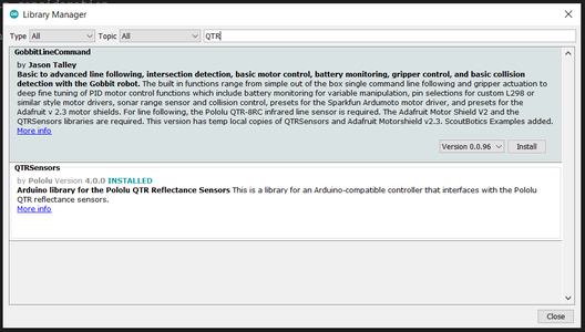

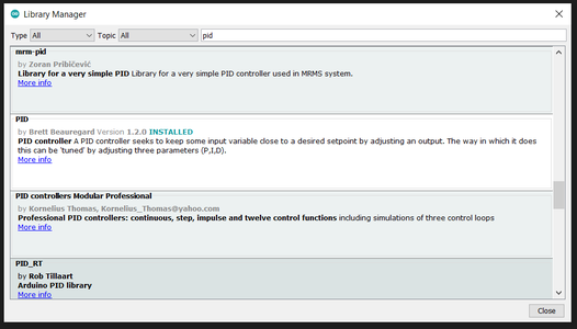

Step 30: Required Libraries
Library for QTR sensor
To read the data from QTR sensor we will utilize library developed from pololu itself. It can be directly installed from Arduino IDE by searching QTR in the library manager.
Library for PID controller
To implement PID control we use library developed by Brett Beauregard. It can also be installed directly from the Arduino IDE by searching PID in the library manager.
Step 31: Building the Track
The shape of the track is totally customizable.
To build the track you can use chart paper (25 x 30 inch) and stick them together to form a bigger arena.
Use pencil to outline the track first and then use electrical tape to form the track.

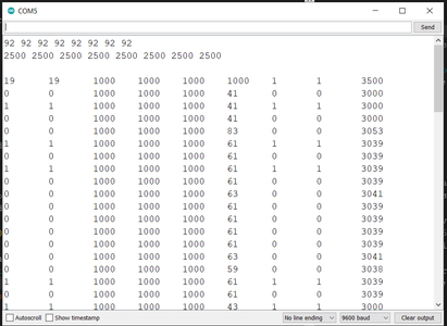

Step 32: Testing and Calibrating QTR Sensor
To test the QTR sensor upload the example sketch QTRRCExample available in the QTR library.
Change the following line of code as the default pins are not the ones we are using.
  qtr.setSensorPins((const uint8_t[]){ 3, 4, 19, 18, 17, 16, 15, 14}, SensorCount);
After uploading open the serial monitor.
The build-in LED indicates the status of calibration. When the LED turns on, it indicates that calibration has started. Move the robot to and fro on the track to calibrate it. Each IR sensor should sense the darkness and brightness at least once. As the calibration time ends the LED turns off and we can see some values on the serial monitor.
The first 8 vertical columns indicate the 8 IR sensors. If the sensor is on dark line then the sensor outputs is greater than 500 and if its on white area it outputs values less than 300.
The last column indicates the position of the robot on track. 3500 indicates the robot is perfectly centered. 0 indicated the bot is to extreme right and if the line position is 7000 it indicated the bot is at extreme left.

Step 36: Is Friction Enough?
As the wheels were printed in PLA material they might not perform well on paper so to improve the friction between the wheel and paper track we can wrap rubber bands over the wheels. Having two rubber bands on each side increases the stability of the wheels.
  • Use super glue to hold the rubber band in place.
Now you are all set to see the robot in action.
Insert the batteries, calibrate it and see the robot in action following the black line.
