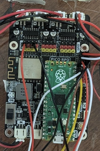

Step 1: Connect Motors to Motor Controller Hat
The motor controller(Pico RPD board) allows us to connect the 4DC motors, PWM pins, and GPIO pins to the pico. The hat acts as an extension board for pico.

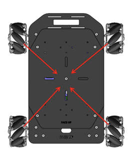

Step 2: Understanding Mecanum Wheels
Mecanum wheels move forward, backwards, as well as spinning in opposite directions to shift right or left. This can be described as "strafing". The rollers of these wheels are placed at a 45 degree angle, allowing them to move this way, and can be altered to achieve movements in different directions. For example, in addition to strafing, the wheels can move diagonally in all four directions.
Step 3: Mecanum Wheel Orientation
Because they are oriented diagonally, it is important to arrange Mecanum wheels in a particular alignment. The rollers should be in an "X" shape, pointing to the center of the car chassis.
Step 4: Mecanum Wheel Control Principle
Now that we understand what the wheels are, and have oriented them correctly, lets get into how we get them to move in the desired directions.
The image above shows the direction each individual wheel on a 4WD moves in to achieve different actions. For example, while going forward means all 4 wheels go forward, going sideways means diagonals move in the same direction).

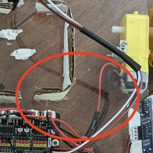

Step 6: Adding Ultrasonic Sensors
The ultrasonic sensors(3x) will use sound waves to detect obstacles in front of them. While one side transmits the sound waves, the other receives the bounced-back wave. Above, I've included both a diagram on how to connect your ultrasonic sensor to RaspberryPico as well as the code logic for calculating the distance of an object, or wall.
By incorporating 3 sensors(one on the left side of the robot, middle, and right), we will ensure that the robot is receiving data from all 3 sides that it will potentially move in, preventing crashes.
If you would like to make your robot move in other directions(ie backwards or diagonal), you could either add a servo motor to turn the existing sensors or simply add more sensors.
