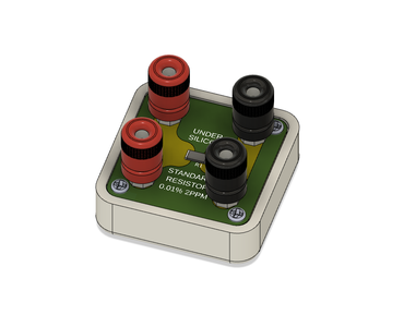

A little side project that can be finished in less than 10 minutes, but still applies as a useful tool for an electronics lab. As I was working on the development of a bigger project, I realised I would need some sort of calibration tool.
So, there you have it, a 4-wire Kelvin measurement Resistor box. It is intended to allocate any 2512 footprint resistor and 4 banana plugs.
The original idea was to use it with 2412 Vishay Precision resistors, which offer 0.01% precision and 2 PPM temperature coefficient, as a cheap way of calibrating an instrument. But this thing also turn out to be useful as a means of testing shunts and check their actual value with a multimeter.
Step 1: Features
The design is anything but complex:
- 2512 SMD footprint
- 4-wire Kelvin connection
- 4 mm holes for banana jacks
- 3.2 mm holes for mounting it inside a little case.

The parts list is pretty short as well:
- PCB Board. You could order it from your favorite supplier.
- A 2512 resistor.
- A set of 4, 4 mm banana jacks.
- A set of 4, 3x10 mm self-tapping screws.
- 3D printed case.
