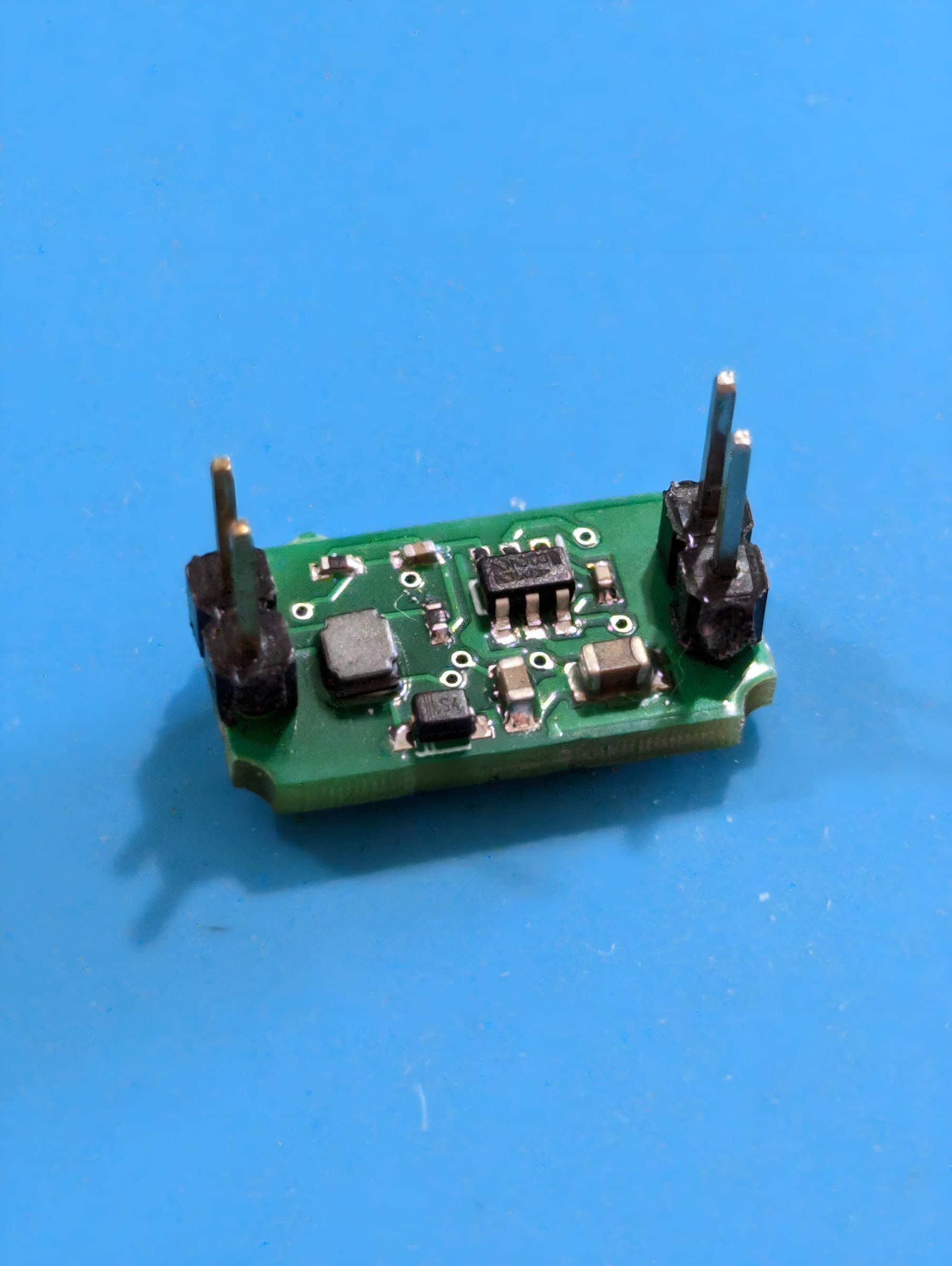

Step 1: The Project in a Nutshell
Our project was born out of the need to control an LED lamp using Pulse Width Modulation (PWM), all orchestrated by an ESP32. We scoured the market for an LED driver that met our needs, but nothing seemed up to the challenge. That's why we decided to create a custom LED control board.
Step 2: AL8861: the Heart of Our Project
The primary component that made our project possible is the AL8861, a high-quality LED driver. With its support for PWM control and energy efficiency, the AL8861 was the ideal choice for our custom LED driver. This component allowed us to achieve impeccable brightness control and an extremely long lamp lifespan, with an output of 40W.
The AL8861 is the beating heart of our LED driver project, and its technical specifications make it an exceptional choice:
  1. PWM Control: The AL8861 features precise PWM (Pulse Width Modulation) control, allowing us to adjust the LED's brightness with remarkable accuracy. With a wide dimming range, it's perfect for creating dynamic lighting effects.
  2. High Efficiency: Efficiency matters, and the AL8861 excels in this department. It boasts an impressive efficiency of over 90%, minimizing energy waste and conserving power for lighting applications.
  3. Wide Input Voltage Range: This LED driver can handle a broad input voltage range, typically spanning from 4V to 40V, making it versatile and suitable for various power supply configurations.
  4. Output Current Regulation: The AL8861 provides consistent output current regulation, ensuring stable and flicker-free illumination even in challenging conditions. It can deliver, for example, up to 1.5A of constant current.
  5. Over-Temperature Protection: To guarantee long-term reliability, the AL8861 includes over-temperature protection. It actively monitors its temperature and adjusts its operation to prevent overheating, with a temperature threshold typically set around 150°C.
  6. Wide Temperature Range: It can operate across a wide temperature range, typically from -40°C to 85°C, making it suitable for both indoor and outdoor lighting projects, where temperature fluctuations are common.
  7. Long Lifespan: With its robust design and protection features, the AL8861 contributes to the long lifespan of your LED lighting system. LEDs powered by the AL8861 can last tens of thousands of hours, reducing maintenance and replacement costs significantly.
These numerical values demonstrate why the AL8861 is at the core of our project. It provides not only precise control over the LED but also ensures high efficiency, reliability, and versatility—essential qualities for any successful LED lighting endeavor.
Step 3: Collaboration With JLCPCB: the Key to Success
No project is truly complete without the right collaboration. Thanks to our partnership with JLCPCB, we achieved the quality and precision we needed to create our LED driver. Their custom PCB production services made it possible to create the control board where we mounted the AL8861. The result? A professional and high-quality finished product.
Step 4: Step-by-Step Build
Now that you have an overview of the project, let's dive into the details. Here's how we created our PWM LED driver:
Step 1: Gather Materials
  • AL8861 LED Driver
  • ESP32
  • Custom PCB from JLCPCB
  • Other electronic components
Step 2: Circuit Design
  • Using electronic design software, we created a schematic of our circuit, including the AL8861 and ESP32.
  • 5 total Pins:
  1. VCC = Upto 40V
  2. GND
  3. PWM
  4. LED+
  5. LED-
Step 3: PCB Production
  • We sent our project to JLCPCB for custom PCB production.
Step 4: Assembly
  • We assembled the components onto the PCB, ensuring we followed the AL8861 specifications.
Step 5: Programming
  • We wrote code for the ESP32, allowing us to precisely control the LED driver through PWM for testing purpose.
Step 6: Testing and Refinement
  • We tested the LED driver and made necessary adjustments to ensure maximum performance.
