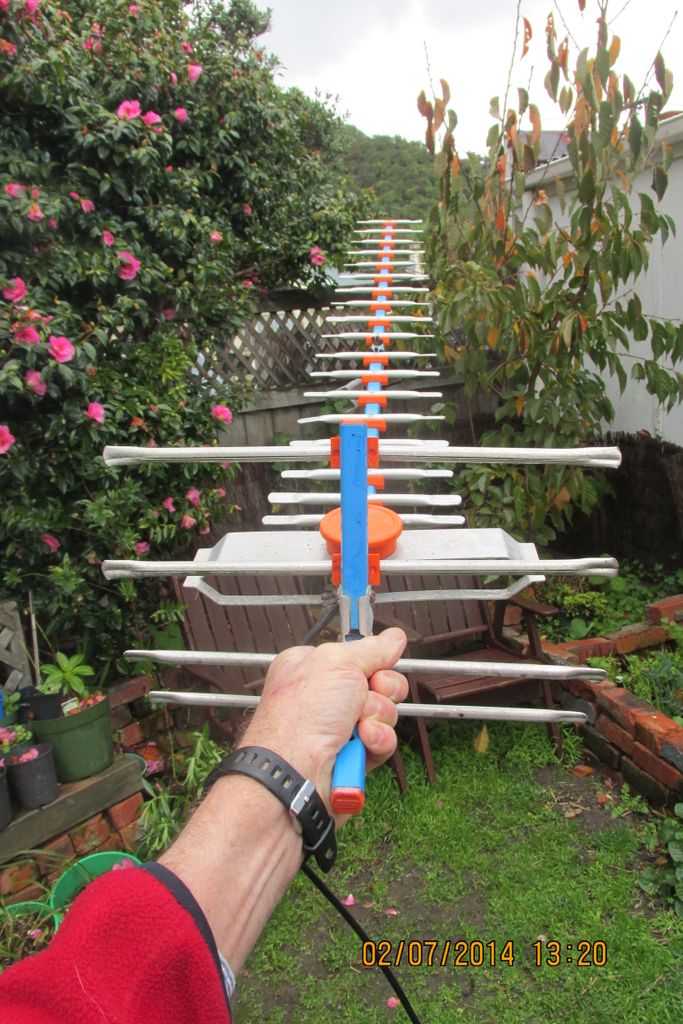

Step 6: Irrigation Hose Fittings
Diverse construction techniques were explored, but garden irrigation fittings & black hose eventually proving the cheapest & most versatile. Shop around however, as some garden outlets often sell these fittings at quite high prices , & the "X" cross pieces are not as abundant as the "T"s.  These  "Pope" branded ones came from the NZ/Australian Bunnings Hardware chain & cost US$1 - $2 each. The black hose can be simply push fitted onto the connections- perhaps use hot water or a hot air gun to assist.
Securing with self tapping screws proved rugged and cost effective. The tape measure itself can usually be bought for a couple of dollars at coin stores etc.  Handy hint- more is less: Combo  imperial/metric tape measures -which are seemingly still made for USA users- are often a hassle to read, & as a result (here in all metric NZ anyway) they may be MUCH cheaper than just metric ones.  The quality combo  Bunnings Hardware sourced one used here cost only ~US$1 !

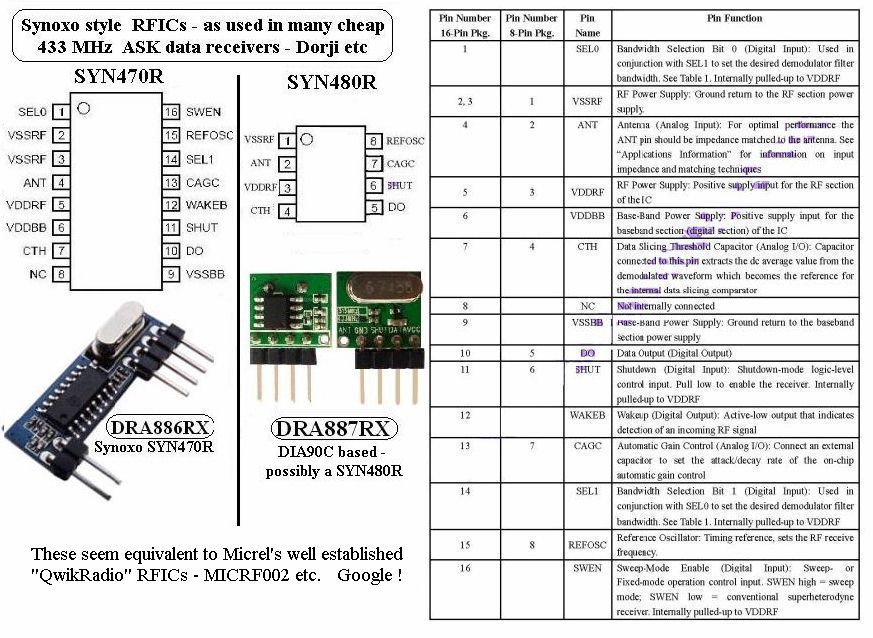

Step 14: RSSI Tap to the Synoxo RF IC
Exploring the Dorji modules SYNOXO SYN470R  RF IC  revealed that a pin 13 CAGC tap offered a valuable RSSI ( received signal strength ) voltage output.  This undocumented AGC (Automatic Gain Control)  output  was of only very low current, but a high impedance DMM on DC volts readily showed a ~1.2 V signal strength variation, ranging from ~1.3 V  when the receiver was beside the transmitter, to ~2.5 V with no signal. ( This later value seemed related to the freshness of the 3 x AA batteries )
Note: Moving coil meters & even low quality DMMs may swamp this RSSI output, in which case a buffering current boosting common collector  "emitter follower" enhancement may be needed.   ( This is under exploration for a final PCB based design )
NOTE: Soldering a wire to this pin can be tricky, as the fine IC pin spacings are only half the normal 2.54mm (1/10th inch). A useful approach involved first crimping a small protoboard flying lead pin over the pin & then soldering while it was thus secured.
Step 15: Assembled Version
Here's the completed 433 MHz antenna, complete with the Dorji receiver & monitoring  DMM. A small snack box suits holding the electronics & 3 x AA batteries, and also makes a convenient operator grip. For directional work a household "Lazy Susan" may suit,although it's metallic bearing my confuse unless the antenna is lifted well clear,perhaps with a block of wood etc.

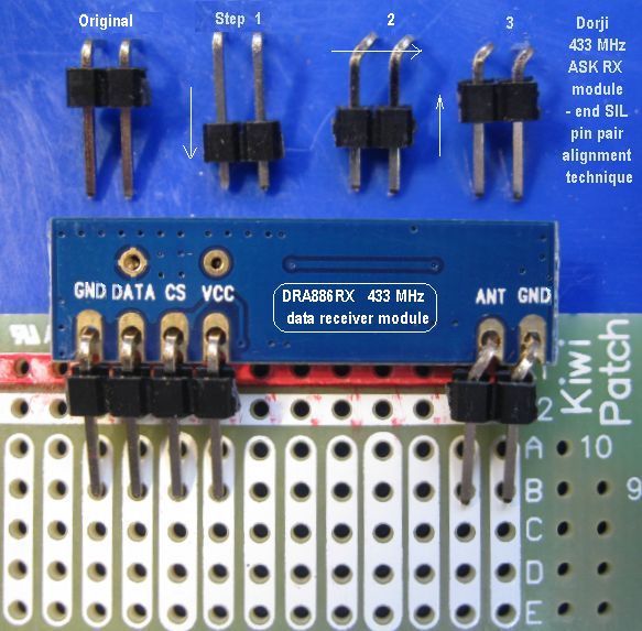

The Dorji RX module ANT/GND pin pair are slightly misaligned. Rather than stress them, best to work on the SIL socket as shown. Note the clean module back that suits an RSSI tap link.

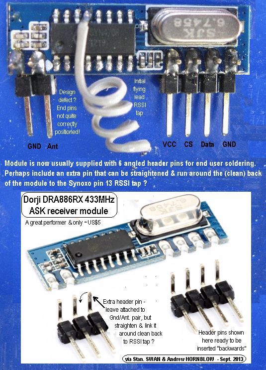

Some Sept. 2013 comments from a keen Kiwi (Andrew "Brightspark") re PICAXEing the Dorji receiver:
I do not like tacking on flying lead wires but an extra pin could be added to the 4 pins when setting up the Dorji as it usually comes with the SIL pins NOT soldered on (in my case) so you could ad a 5 pin SIL at the business end of the Dorji with one protruding under!?
The whole object has been to READADC simply and directly with least fuss the RSSI value direct from the Cagc line. = One Wire project The 10~50 MegOhm input impedance of the PICAXE pin is not likely to upset the radio This has least impact or issues or risk of loading the RF Rx superhet radio or causing any effects NO PARTS = One wire and a readadc 1, b1 command.
If you wanted to drive a moving coil meter why not use the PWMOut to scale and buffer the readadc value in software ? Squelch is also a great idea... It would be a s simple as saying 'if b1 < 100 then 'threshold of squelch".
Gating the radio for super battery life with the Dorji is all there and waiting since you have the enable pin to * Turn on the radio (low 4) etc * Sniff Cagc level * If b1 < 100 then (there is activity on the channel so time to wake up) *Keep squelch open or go back to 'sleep for x' If you want to 'fox hunt' then just convert the Cagc voltage to a pitch change and or pulse of the sound command to make it beep faster and at a high pitch as you get closer to the target etc...
0
manuka
manuka
Reply 7 years ago on Introduction
Of course-but solid core copper wire it is not as flexible as tape measure steel and will soon break if folded up often. Copper is costly too!
