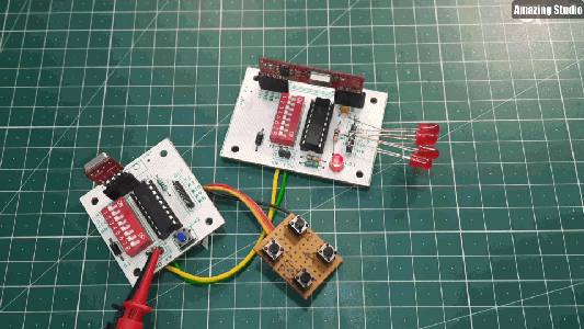

Hello guys, today we are going to setup our 433Mhz transmitter and receiver modules with their supporting cards. We are using cheap 433mhz modules and we are not using any microcontroller with this. The dedicated encoder and decoder IC’s can do the job perfectly.

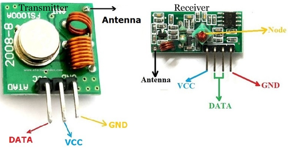

Step 2: 433MHZ Modules:
Cheapest RF (Radio frequency) modules available in market and these are available easily on eBay, amazon. For 433MHz we need about 17.3 cm antenna for proper communication, The range is up to 100meters. Which make sense to use these modules inside homes as remote-control devices for lights, fans, tv and toys like cars.
The two types of modules are available but the Red colored one is working fine in all the applications, Also this one has a crystal oscillator which communicate directly with receiver. The second(green one) module has a coil and capacitor rasonator circuit, which I will not recommend to use in high end applications.

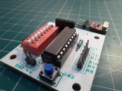

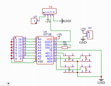

Step 6: Circuit Description: Transmitter Section
Here in diagram, We are using HT12E is used to encode the data from the button pins and then sent to receiver part by 433mhz module. So, for oscillations we are connecting 1Mohm resistance as mentioned in the datasheet of the IC. Also there is one big DIP switch, which helps to select 8 different channels. Simply meaning that we can run 8(transmitters and receivers) at one place without interference. So that’s a very good and helpful update here. We can attach four tactile buttons or something like PWM signal to the input terminals for the data to get transmit. We have to give an active low signal for triggering. You can order these PCB directly from JLCPCB using this link here https://jlcpcb.com/SSRF.
Specifications of 433MHz RF Transmitter Module: –
  • · Max range with the antenna in normal Conditions: 100 Meters
  • · RX Receiver Frequency: 433 MHz
  • · RX Typical Sensitivity: 105 dB
  • · RX Supply Current: 3.5 mA
  • · RX IF Frequency: 1MHz
  • · RX Operating Voltage: 5V
  • · TX Frequency Range: 433.92 MHz
  • · TX Supply Voltage: 3V ~ 6V
  • · TX Output Power: 4 ~ 12 dB

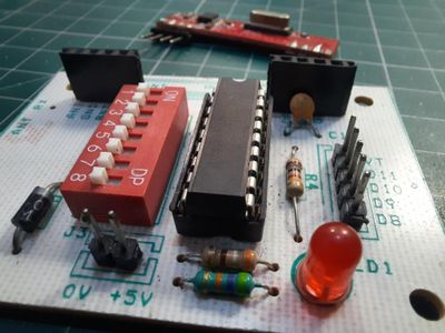

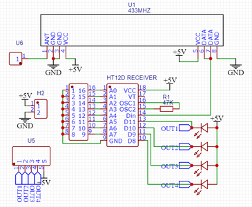

Step 7: Receiver Section:
Contains an 8-pin big module and here we are using HT12D, decoder IC. The transmitted data is received by module and then decoded by HT12D decoder. Here for oscillations we are using a 47k resistance and both the modules are supplied using 5v. We get the data in the format of active low signal. The amplitude of received data is too low, So a transistor or motor driver can be used to get the better output from this. Surely for now, we are using 5mm led’s to show the received data.5 pins on the circuit is to get the output and to connect it with a proper driver circuit. Order these PCB in just $2 from JLCPCB, If you Sign-up using my link(https://jlcpcb.com/SSRF) In addition you will get 4 coupons of worth $27. Which contain $9 Smt coupon and other PCB coupons.
As a driver, we can use transistor in switching mode, for digital signals. And motor drivers like, l293d and l298n.

The HT12D Decoder ICs are series of CMOS LSIs for Remote Control system applications. These ICs are paired with each other. For proper operation a pair of encoder/decoder with the same number of address and data format should be selected (HT12E is paired with HT12D). The Decoder receive the serial address and data, transmitted by a carrier using an RF transmission medium and gives output to the output pins after processing the data.
