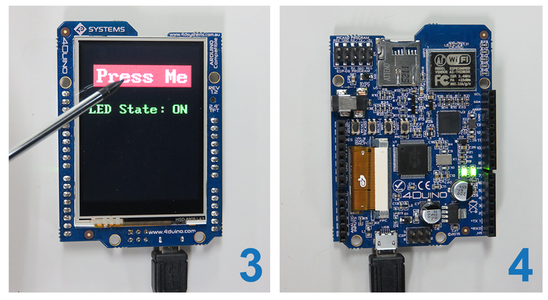

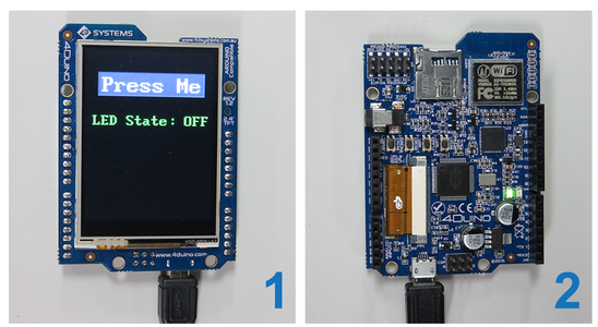

User provides a touch input by pressing the button on the display. Picaso (graphical controller) which drives the display, receives and processes this touch input. Picaso controller communicates the information to ATMega32U4 via Hardware Serial (D0, D1)
As per the program, ATMega32U4 sets the D13 pin of the 4Duino HIGH and turns the LED on. In addition, ATMega32U4 requests Picaso to update the LED State on the 4Duino Display

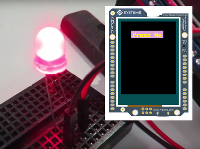

4Duino has an inbuilt LED connected to the I/O pin D13. Circuit building is not required at this stage.
But if you want to use an LED, connect it to D13 pin of 4Duino with 220 Ohm resistor on its ground.

The state of the LED on D13 can now be controlled via the button widget on the display.
You can also extend this project by using the GPIO pins of 4Duino and modifying the program.
