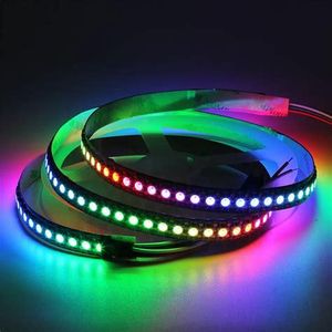

6 effects simultaneously on 4 WS2812b 3m (60-LED) strips.
4x WS2812B 3m 60 IP67 strip
Arduino Uno
4x Resistor 4.75k ohm
4x LED light strip, cable, 3 pins
Step 1: Info
Connection Resistors to strips on PINS 5, 6, 7, 8.
