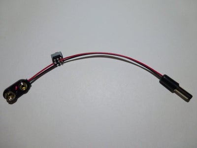

Step 6: Installing the Arduino/ Power Supply
Take the sliding switch and cut the mounting tabs off with the wire snips on the needle nose pliers. Next, cut and strip the positive wires of the power supply and solder the switch to the positive leads.
