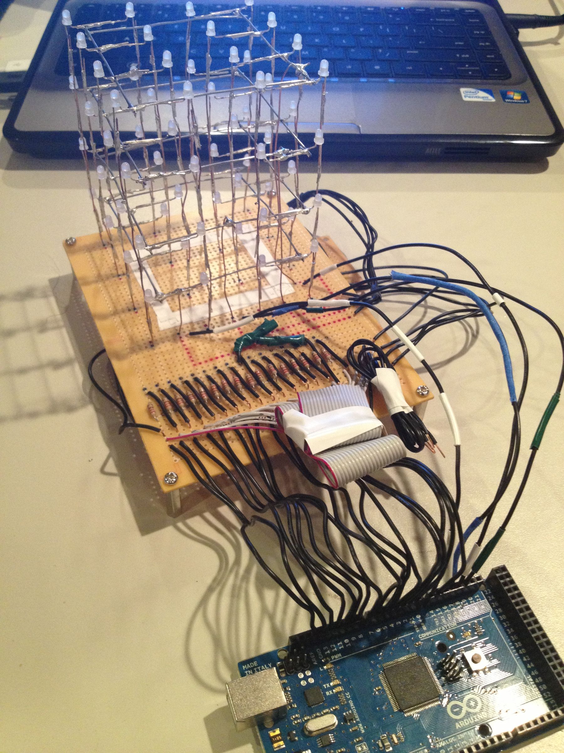

The cube is split into 4 layers of 16 LEDS.
All the LEDs aligned in a vertical column share a common anode (+).
All the LEDs on a horizontal layer share a common cathode (-).
Now if i want to light up the LED in the upper left corner in the back (0,0,3), I just supply GND (-) to the upper layer, and VCC (+) to the column in the left corner.

Its made with 4 NPN type transistors. and 22k ohm resistors. In a nut shell connect all the collectors together, theses all go to a ground pin on the Arduino. Then all four bases should go their own pin on the Arduino. Lastly the Emitters should go to the layers on the Cube. (Look at picture 2 and it will make since.
The first picture is of both boards to understand how they connect to each other and the Arduino.
The second picture is my drawing of the transistor array controlling the 4 ground layers.
The third picture is the actual Transistor ground board. (The Bottom)
The Forth picture is the actual Transistor ground board. (The Top)
Second Make the main cube board:
All that really happens on this board is that all 16 columns are connected to the Arduino through a 220 ohm resistor.
Also all four layers come into this board and then leave to the transistor Board.
The fifth picture is of the entire Cube board. As you see all columns are connected to a 220 ohm resistor the another wire comes out the top of the board and goes to the Arduino. Also you will notice that the wires are kinda on the resistor backwards to common since. this is because the first time i did this i completely forgot the resistors....so i did some improvising and it is kinda backwards to normal thinking. Therefore you be smart and do it right the first time. so if you do it right it does not have to look like mine however you can if you want.
The sixth picture is a close up of all the connections. The four big solder trails are the 4 ground layers that leave the board to the transistor board.
The seventh Picture is of the top of the board showing where the wires leave and go to.
The eight picture shows where the Layers enter the board. Just connect a piece of stripped wire to the layer and then bring it down to the board. make sure these wires don't touch any other wires .... this would cause a short. however take all the insulation off so that you cant really see them in the cube.
The ninth picture shows the connection between the two boards. As i said before, i am not that good at soldering yet. if your good you could cram all this on one board rather than two.
The last picture shows the column numbers so column 1 is connected to resistor 1, and then resistor 1 is connected to pin 13 on Arduino...you can figure out the rest :)
