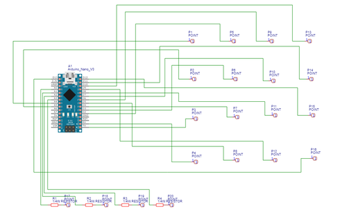

Step 5: ASSEMBLING COMPONENTS ON PCB
  • First solder the 100 Ohm resistor On PCB
  • Then Solder Female Header pins in to the PCB Board
  • Connect the arduino nano header pin.
  • After soldering all the components, solder the LED Cube to the PCB
  • solder each layer pins to PCB (1,2,3,4 - The picture can be seen above)..

Step 8: SCHEMATIC DIAGRAM
