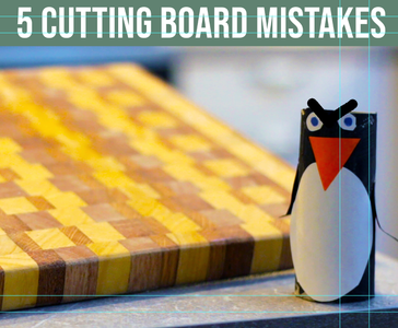

Step 3: Step 3: Realise Your Mistake and Fix It
In my case I added a TON of clamping pressure to keep all the glue seams closed, think like the pressure at the bottom of the marianas trench, and not enough pressure to keep the boards flat. So I created a Pringle shape. Yay :)
I made the same face as the toilet roll penguin does here.... ( MISTAKE 1)
To fix that I used a router flattening jig, there are many designs online, it is a simple tool that lets you run a router with a flat bit over your workpiece to take out the highs and lows and thus create a flat board.
After creating a mountain of sawdust I had a flat board that was technically already a useable cutting board.
I did go way to deep at the start and ended up cutting about half the thickness of the board away before realising just how much material I was removing
(MISTAKE 2)
