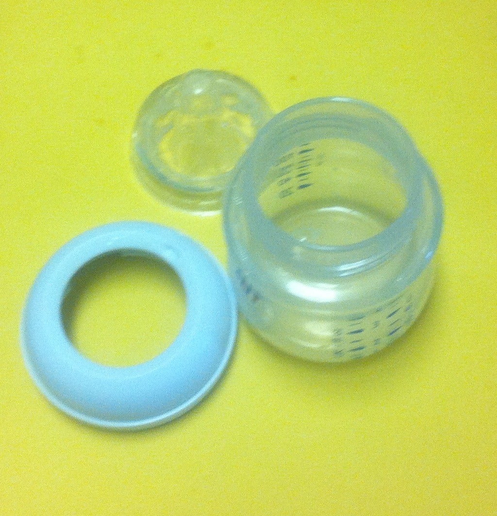

Step 4: Trim the Nipple Ring
Now lets start disassembly and trimming:
Simply unthread the ring from the bottle and then remove the nipple.

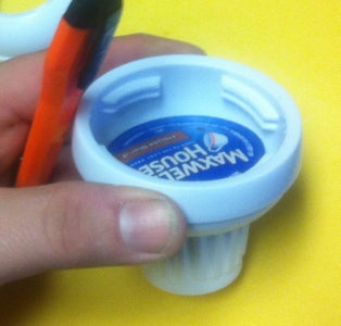

With your cutting utility, carefully, remove material from the inside diameter of the ring until the K-cup will fit inside as seen.
This oversized inner ring threads I trimmed material from also giving me more room to seat the K-cup.

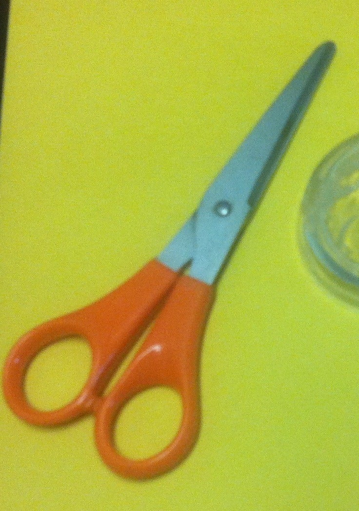

Step 5: Trim the Nipple
The clamp ring part or our micro brewer is done. Now make the gasket.

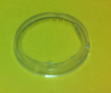

Basically cut the center section from the nipple so you are left with a just a sealing ring.
Scissors were the easiest thing to use for me. Again be careful .
This gasket will be placed on the top of the K-cup after it is inserted as seen in the last pic.

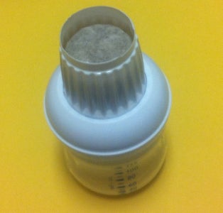

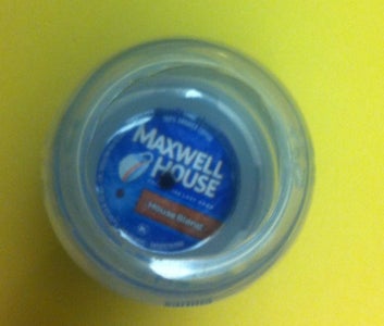

Step 7: Assemble and Make Some Joe
With the bottom out of the bottle assemble the unit will look as seen above.
Poke a hole in the top of the K-cup foil.
Then either poke multiple holes in the bottom (don't go too deep you will puncture the filter)
Or cut the rim off the bottom of the K-cup as I did. The later for the bottom will make your coffee faster.
Now just boil or heat some water and pour it in while holding the brewer over your cup. (The separator in the pic holding the unit over the mug is just a piece of plastic from an old notebook binder with a hole in it)
Drink coffee to test quality.
Always rinse/clean your unit between uses.
Now you have a portable K-cup brewer that can be made for less than $5.
