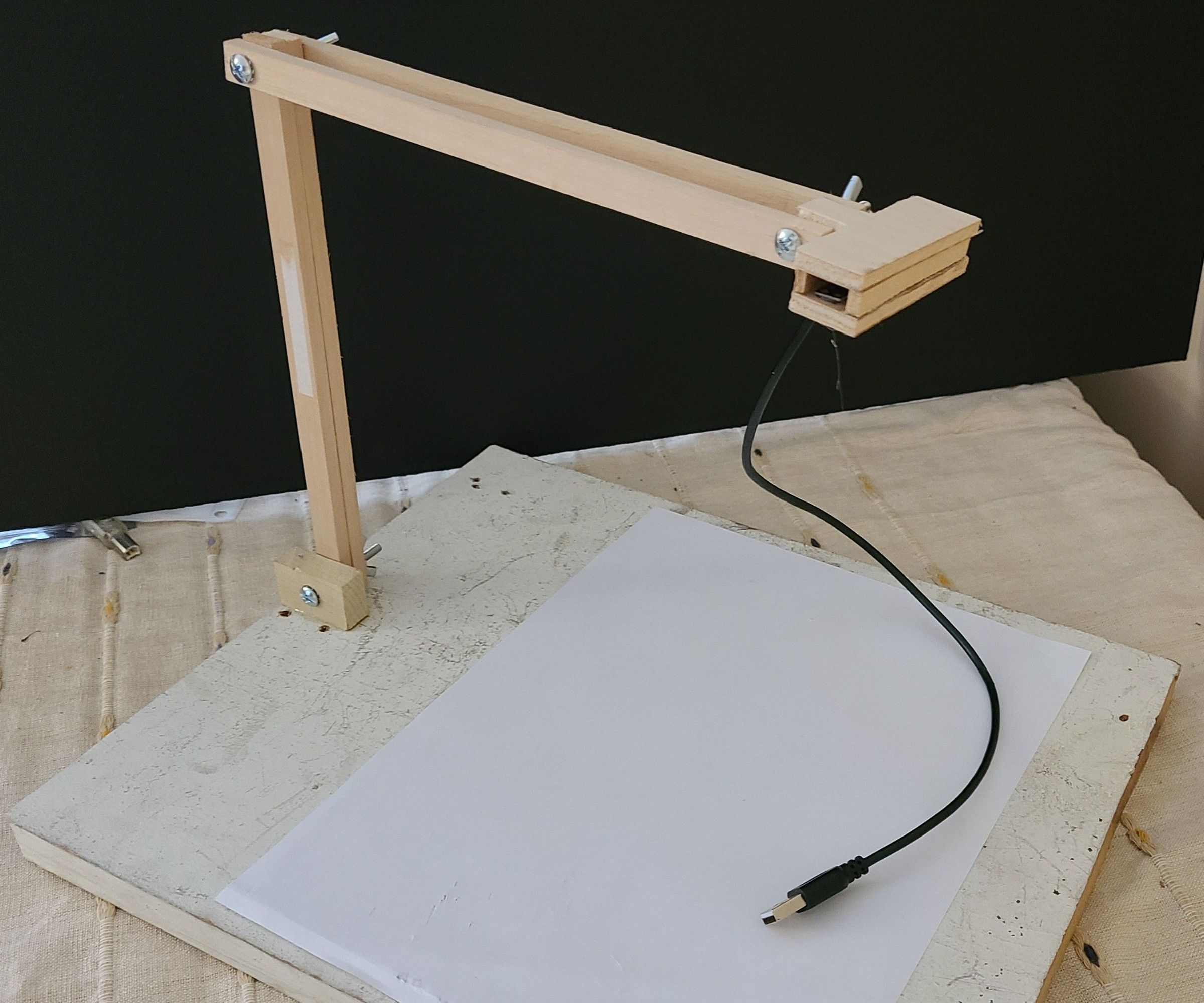

I recently published an Instructable demonstrating the use of a laptop camera module to make a desktop document camera for video conferencing.
www.instructables.com/id/A-Sub-10-MetaPrax-Documen...
I demonstrate below how to adapt this concept to use on a laptop computer. Advantages include lower cost than the desktop version, the camera and arm are easy to remove and set-up, the arm is portable, and right and left hand use is easily accomplished by inverting the camera on the arm. I apologize in advance that the construction is rudimentary as I used hand tools and left over material. When I have the opportunity to 3-D print the camera shroud and 3-D print an attachment mechanism to the arm I will update.

Step 2: Camera Support Arm
The camera is supported on a ½” x ¼” x 10” strip of wood available at home improvement stores or lumber yards or cut from larger stock if you have a table saw. A hole is drilled and a slot cut in one inch from one end to accept a 2 ½” #8 screw with 32 threads per inch. The screw is glued in place and a thin piece of wood is glued to each side to strengthen the assembly.
The arm is held to the exterior shell of the computer screen using Velcro type material. The loops (fuzzy side) are adhered to the arm and the hooks are adhered to the outside of the computer shell.
Step 3: Camera Shroud
The camera module shroud was cut in a T-shape from 3/16” thick birch plywood. A hole was drilled for the camera and the module was hot glued in place and sandwiched with spacers between the upper and lower pieces of plywood. If you have a laser cutter you can achieve better fit and finish than my quick hand cuts. If you have a 3D printer I suggest printing a case to make attachment to the arm more convenient and to protect the camera board. Also cable routing and strain relief can be incorporated into a 3D printed case. Remember that the camera module is meant for a laptop and the long side of the board corresponds to horizontal. If the camera orientation is changed you would have to rotate the image in software and not all video conferencing software may support that function. The camera shroud is held to the arm with a #8 -32 wing nut. By using a screw to hold the camera in place, if the laptop screen angle is changed the camera position can be changed.
