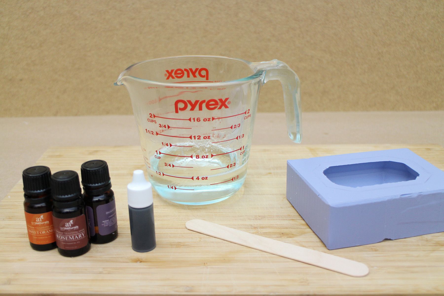

Here are the tool and ingredient lists for making both translucent and opaque soaps:
Tools
- Microwave safe glass measuring cup
- Cutting board
- Sharp chef's knife
- Small spoons or wooden stir sticks
- Soap molds*

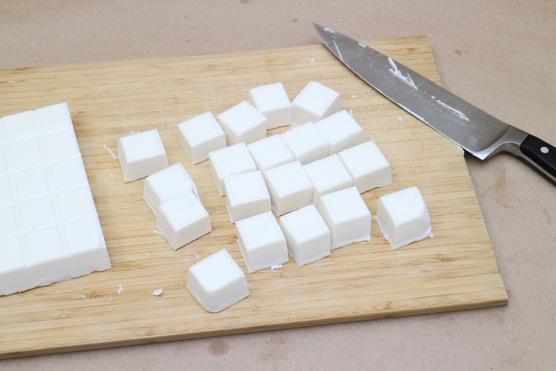

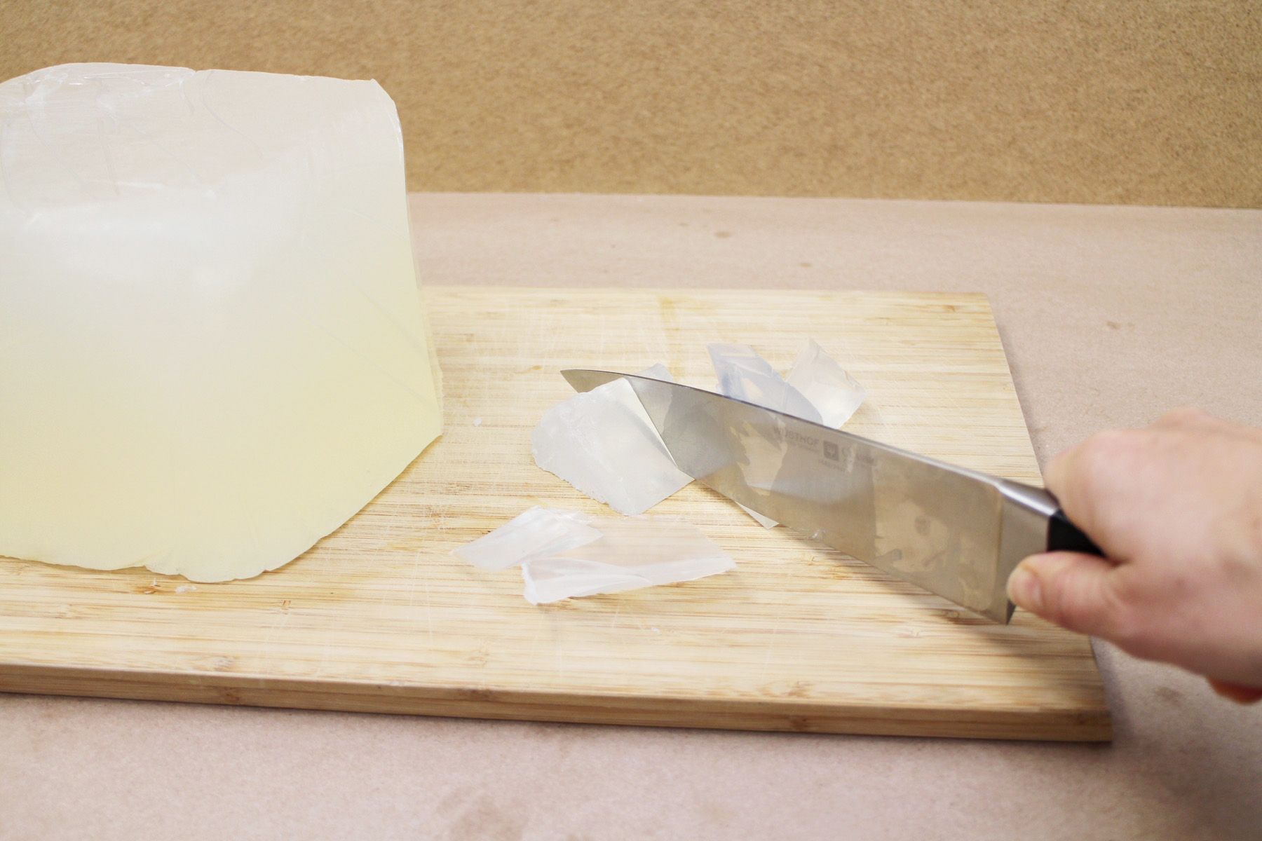

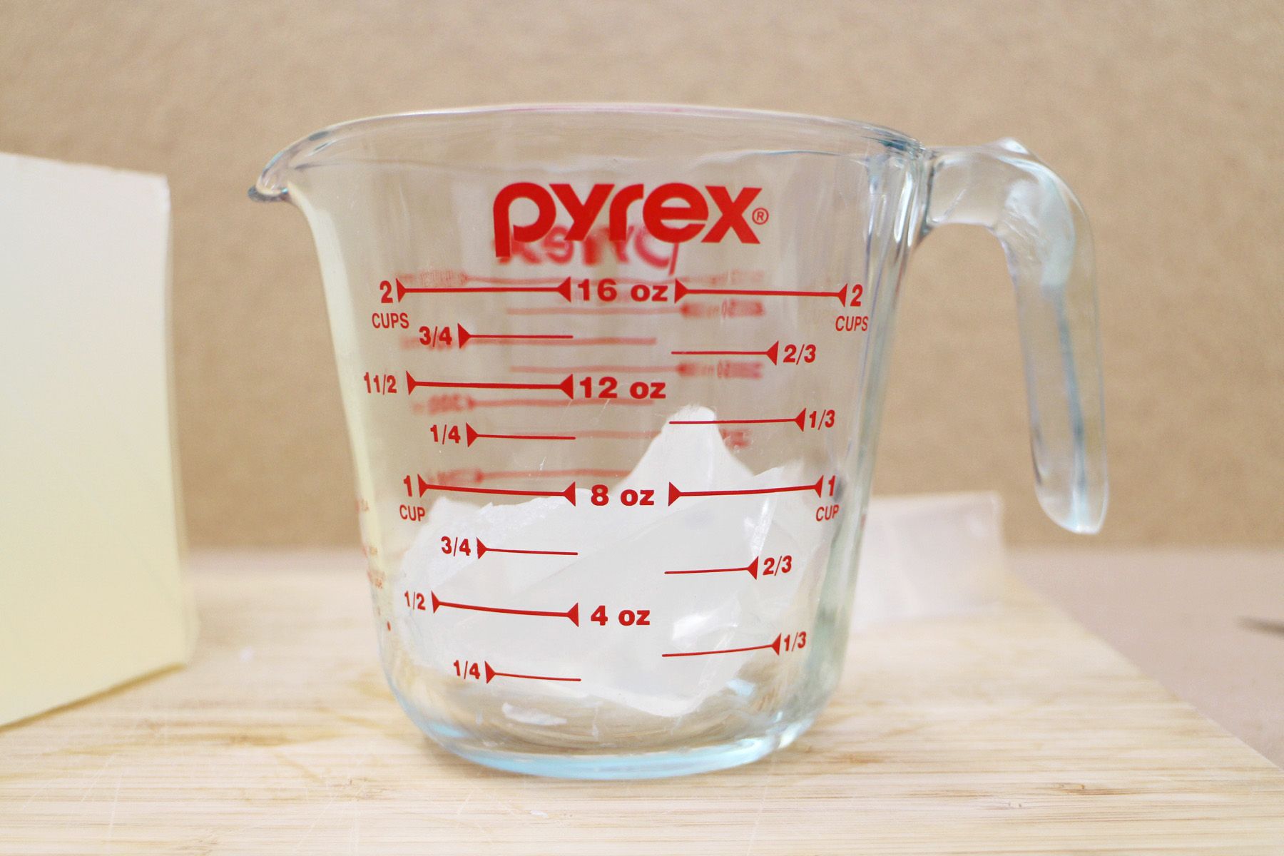

Step 2: Cut soap base into chunks and add required amount to glass measuring cup.

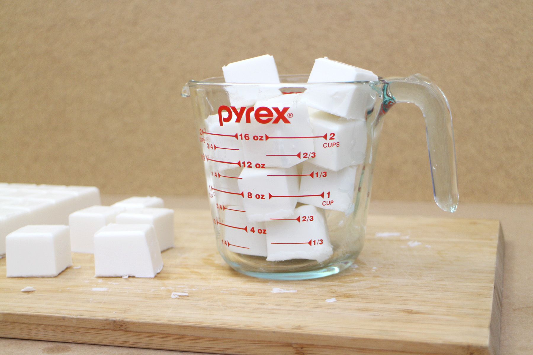

Cut the soap base you're using into small cubes or chunks with a sharp chef's knife. Add pieces to a microwavable glass measuring cup until they reach the line that is twice as much as the final amount you need.
For example: If you need 4 oz of melted soap base to fill your mold, fill the measuring cup to the 8oz line. We do this to compensate for all the spaces and gaps between the pieces.

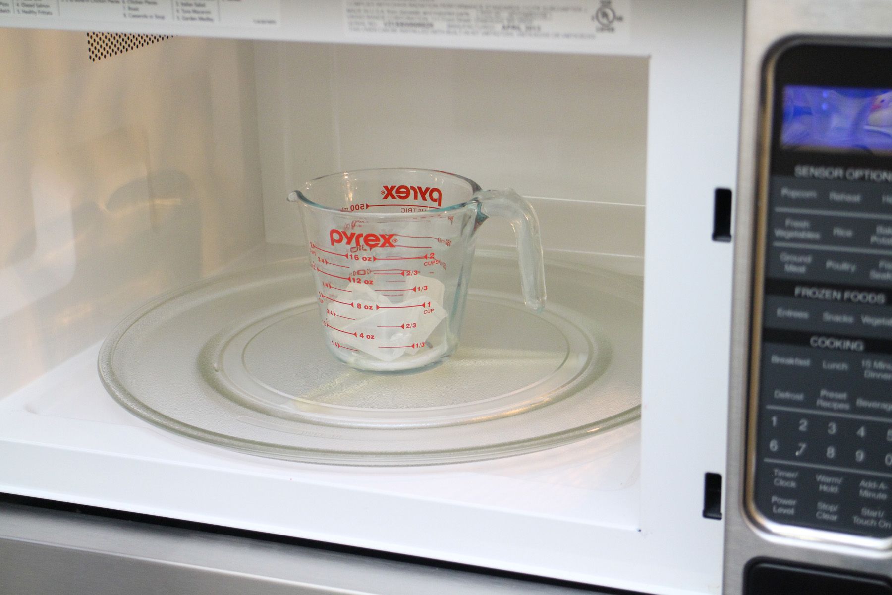

Step 3: Melt the soap.
To melt the soap, place it in the microwave, one batch at a time, for 30 second intervals until it is completely liquid with no chunks.
If you miscalculated and need to add more soap chunks to the melted amount in order to end up with the correct volume, that's ok to do! Just add them in, and microwave in 15 second intervals until those have melted.

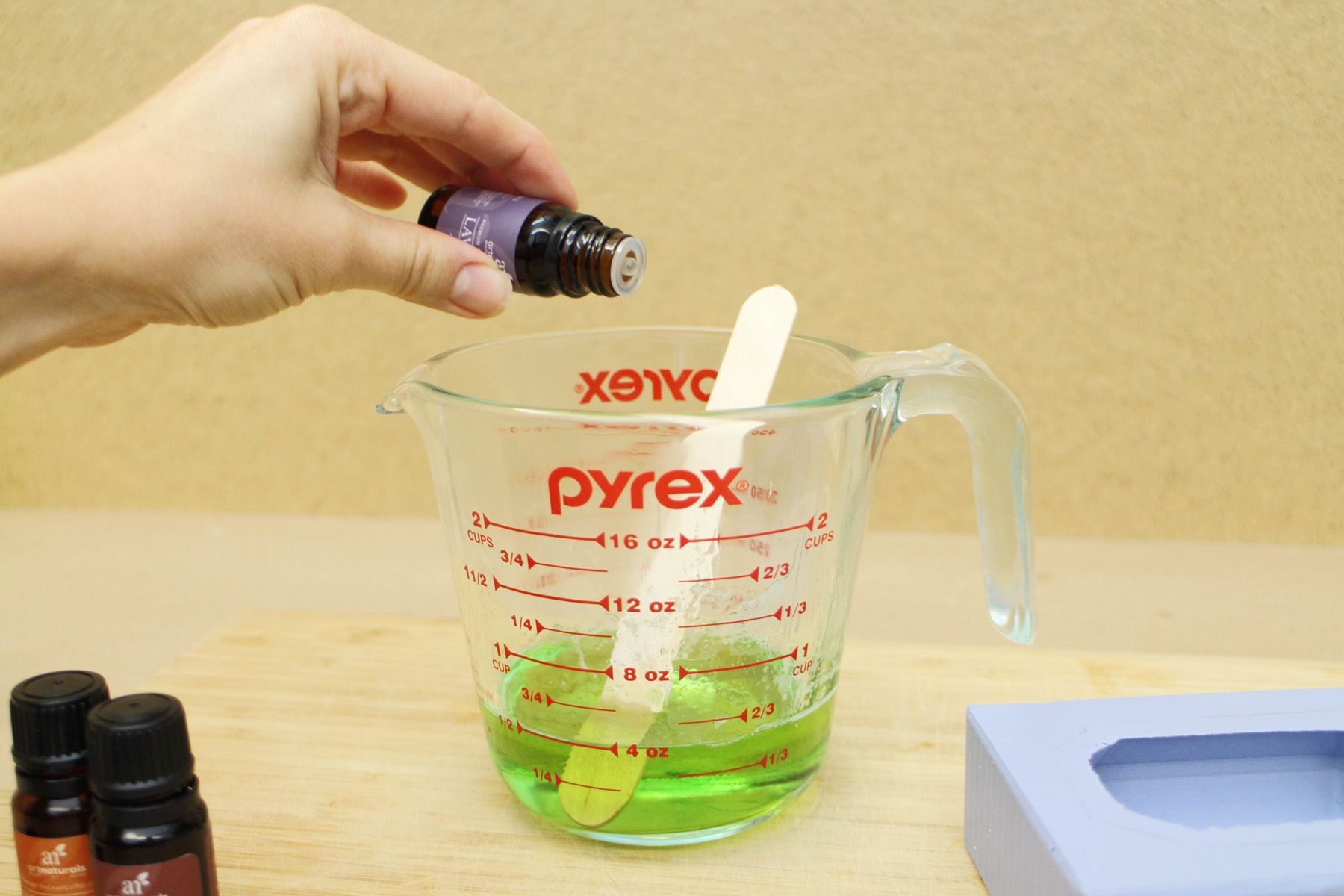

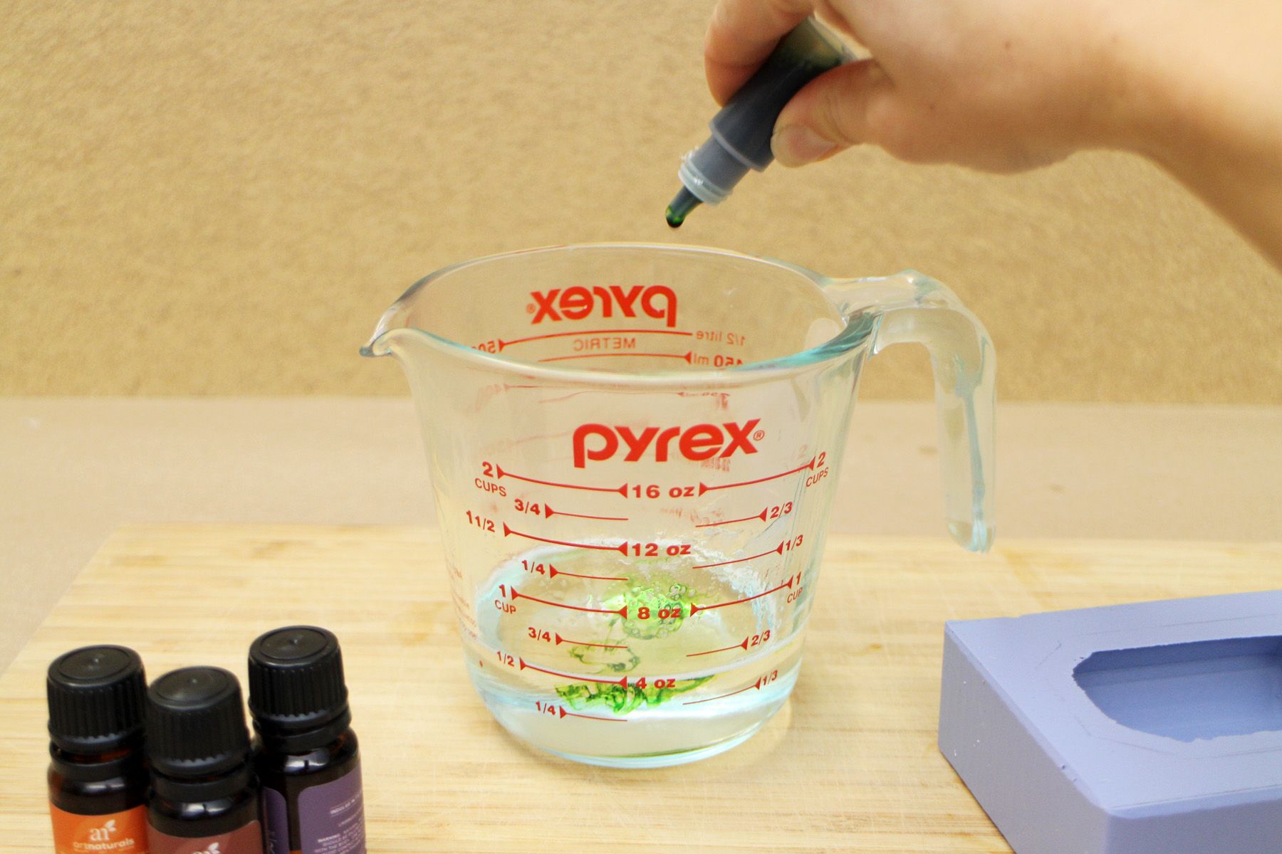

Step 4: Add the coloring and scents.
Once the soap is completely melted, add color and essential oils if you wish.
For the 4 fl oz bar sized translucent 'gem' soap, I added 10 drops of color and 4-5 drops of essential oil. For the 11 fl oz opaque 'ducky' soap, I added 40 drops of color and 10 drops of essential oil.

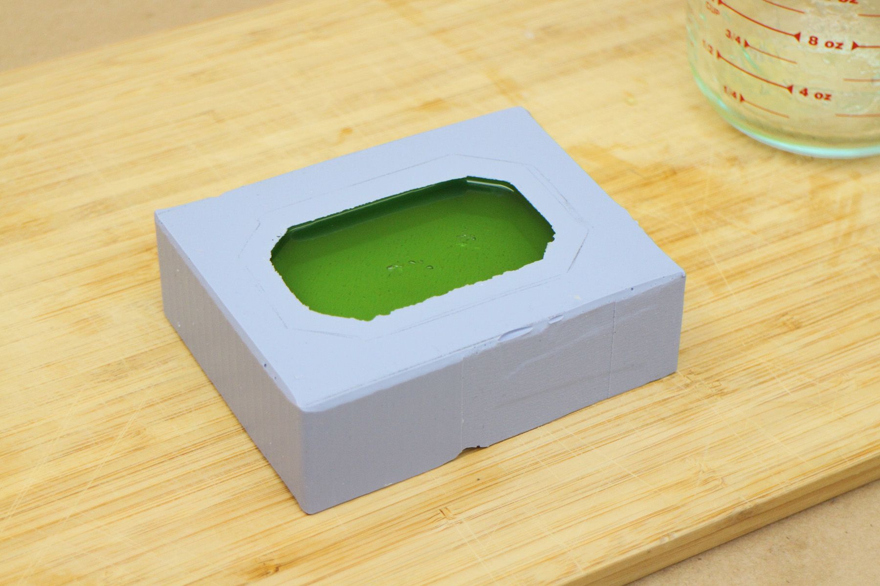

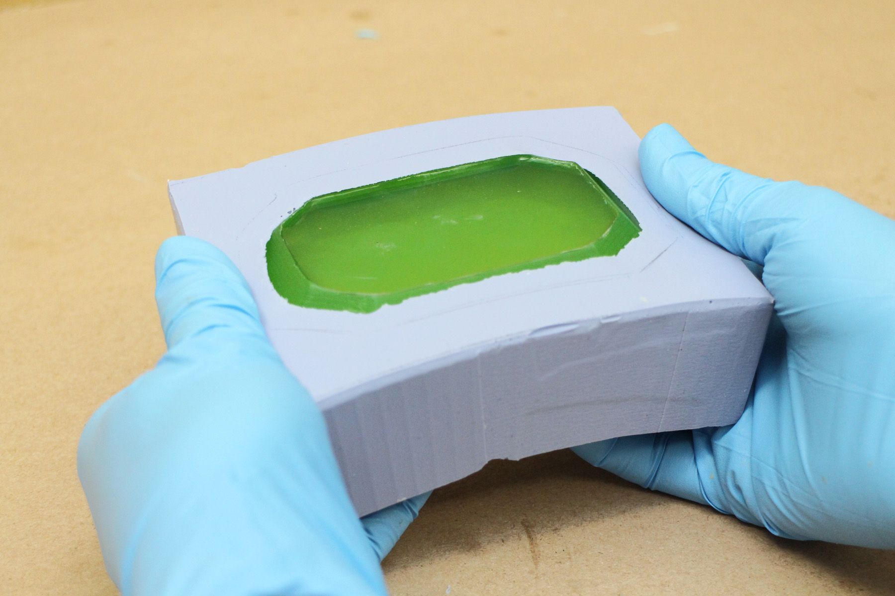

Step 5: Mix and pour.
Stir the mix well and pour it slowly into the molds until the mix reaches the top edge of the mold.
Let sit undisturbed until the soap has solidified. The time this takes will depend on the size of your mold – anywhere from 30 minutes to 2 1/2 hours. The great news is though, that your 5 minutes of making are up! So you can now just kick back and do another thing while the soap hardens. :D

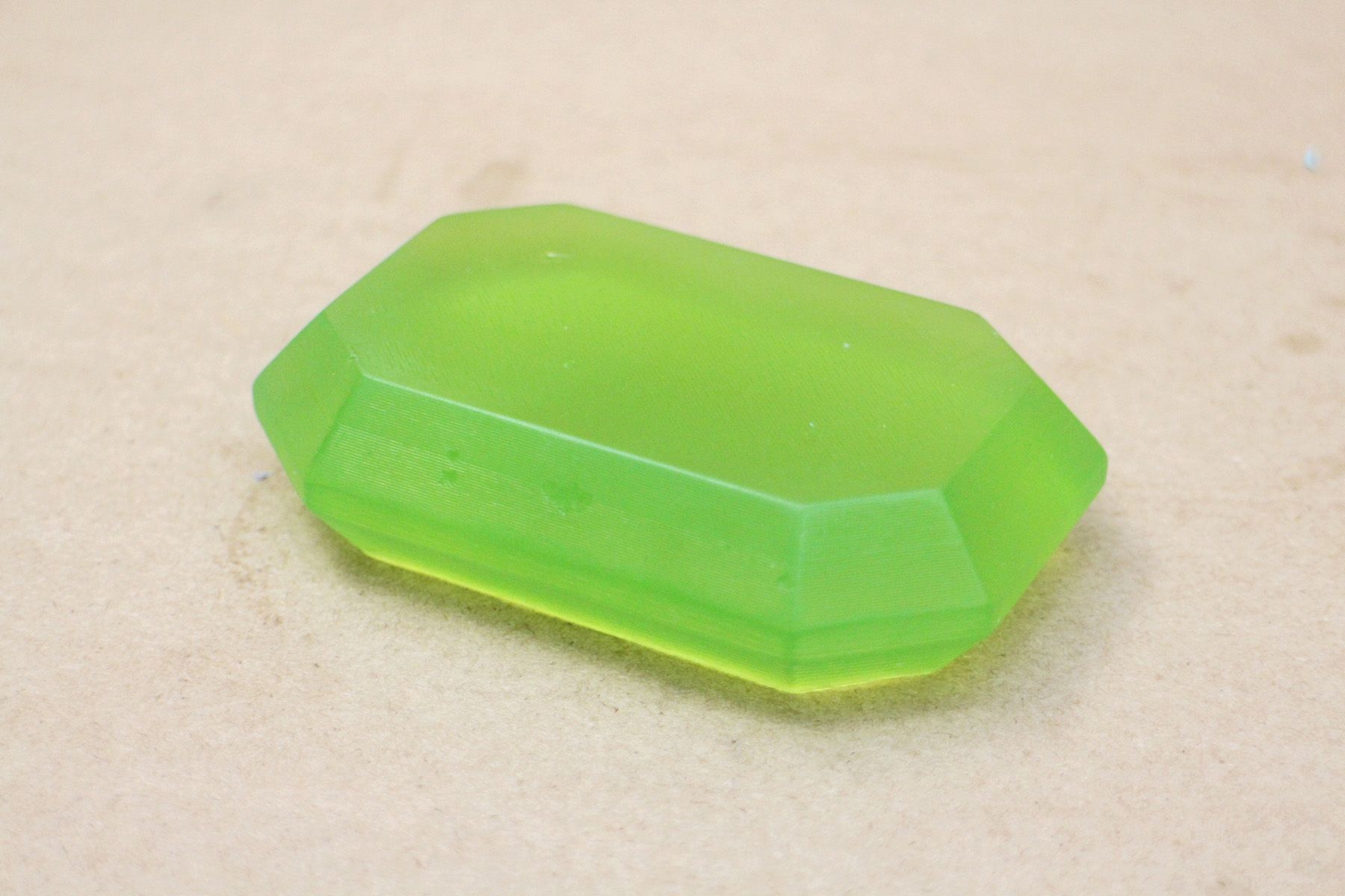

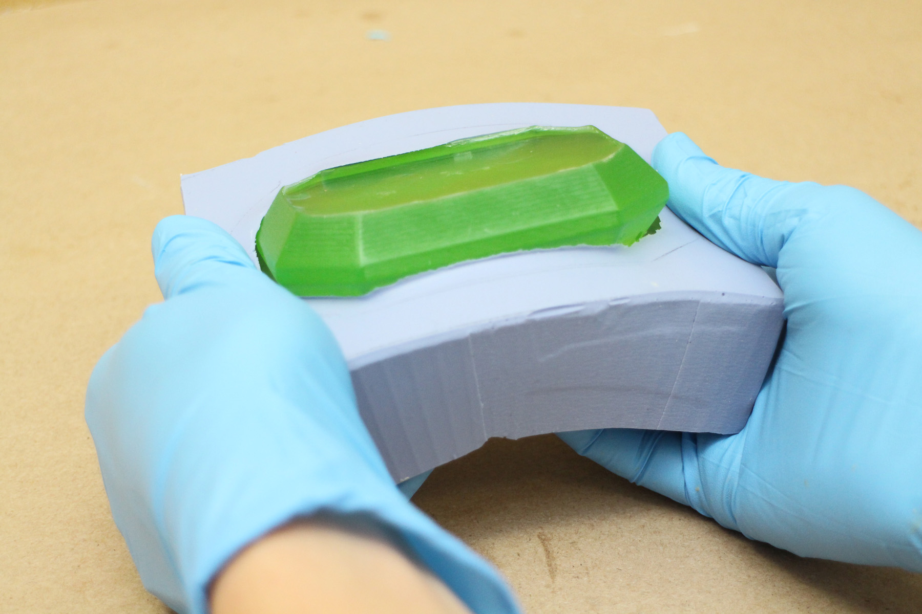

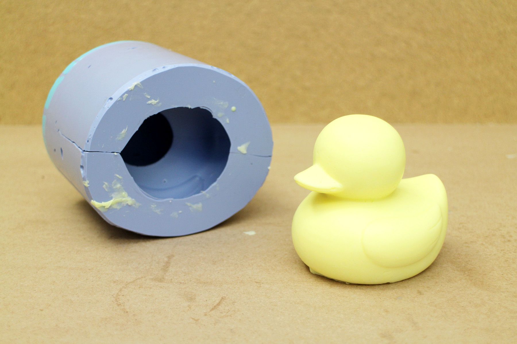

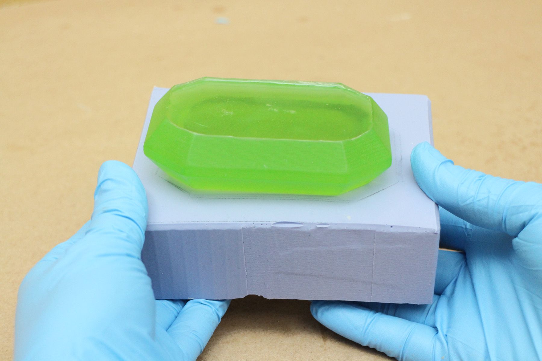

Step 6: Demold the soap.

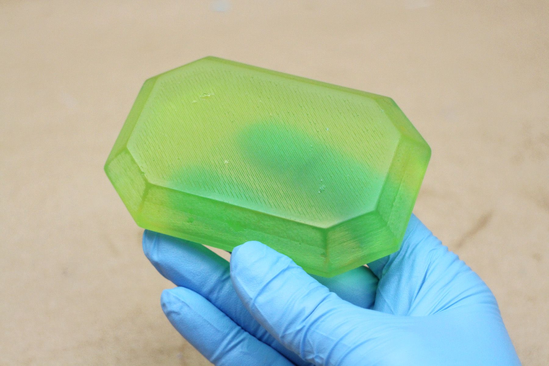

Once the soap has set, carefully remove the soap from the mold, much like you would an ice cube from an ice cube tray.
And there you have it! These make great gifts and can be a fun afternoon craft project with friends.
