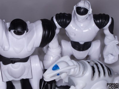

Beginning in March 2007, WowWee Robotics, the makers of the Robosapien line of robot toys, began including a familiar face inside McDonald's restaurant Happy Meals. For the price of a Happy Meal (nominally around $2), "boys meals" featured one of eight different WowWee Robotics toys. Conversely, the "girls" Happy Meal included a My Little Pony premium toy.
The eight robot toys were:

- Robosapien - #1; walking (mechanical)
- Roboraptor - #2; vocalizing (electronic)
- Robosapien V2 - #3; talking (electronic)
- Roboreptile - #4; rolling (mechanical)
- Robopet - #5; walking (mechanical)
- Roboraptor - #6; chomping (electronic)
- Robosapien V2 - #7; standing (mechanical)
- Roboreptile - #8; biting (electrical)

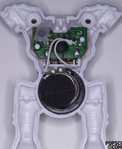

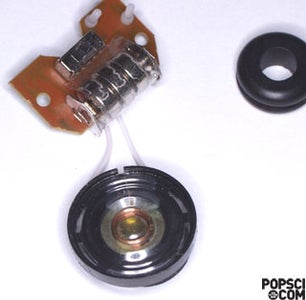

Inside the chest cavity there is a miniature circuit board with a rubber pushbutton switch. Attached to this circuit board is a small speaker connected via two short wires and a set of three button cell batteries. This entire assembly is held in place by two white plastic posts. Use your handy narrow blade straight screwdriver to gently pry the circuit board up and off of these two plastic posts.
Note: the three button cell batteries could "spring" out of the circuit board's battery clips. Don't lose these batteries. Keep them together with a short piece of transparent tape.

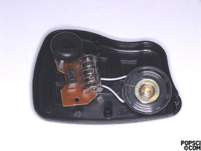

Insert the batteries (held together with a piece of transparent tape) into the voice box's battery clips. Slide the power switch into the "on" position. Make sure that the voice box is working properly. Press the rubber pushbutton. Drop the working voice box into the Serpac enclosure. Center the voice box's rubber pushbutton underneath one of the enclosure's pushbuttons.
In order to ensure a snug fit underneath the enclosure's pushbutton, lay a rubber grommet, salvaged wheel from a toy car, or some other insulated material over one of the rubber posts on the back of the circuit board. Join the keychain enclosure together and test the operation of the voice box.

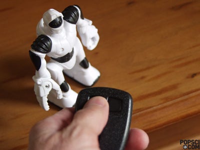

As long as you leave the voice box's power switch "on," you can play one of the RS V2 nano's canned messages with the press of the button on your new WowWee Robotics Keychain.
