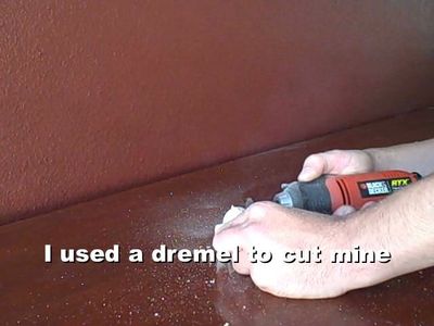

Step 2: Cut and Drill
Begin by cutting the 3/4" "T" coupling in half lengthwise. I used a dremel to cut mine.
Then drill a 1/4" hole in the center of the threaded end cap.
Then install your hex bolt , washer and nut through the top of the end cap.
Screw the cap onto the 3/4" "T" coupling.
