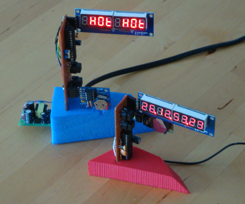

The students followed the pictures. They know about circuits and had practiced with the LDR-resistor combination during one evening with the ARDUINO.
  • Solder to the chip holder, mind the "North" sign on this holder.
  • First the resistor to pin 8 (V) and PB2, then the LDR to PB2 and pin 4 (GND).
  • The battery holder to pin 8 (plus) and pin 4 (GND)
  • the short legs of the LED's to pin 4 (GND)
  • the long legs to pin 5 and 6, PB1 and PB2.
  • (You could add a switch.)
If all is soldered, insert the programmed ATtiny85.
You have to put the speed on 8MHz with AVRdude setting the fuses:
avrdude -c USBASP -P usb -p t85 -U hfuse:w:0xdf:m -U lfuse:w:0xe2:m
