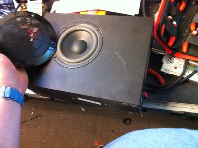

So I disassembled the computer speaker subwoofer. Found some great parts for other projects in the future.
I tested the speaker, that worked, so onward.

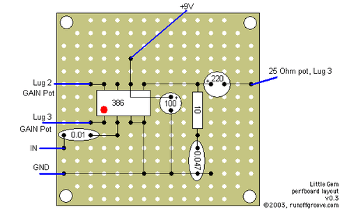

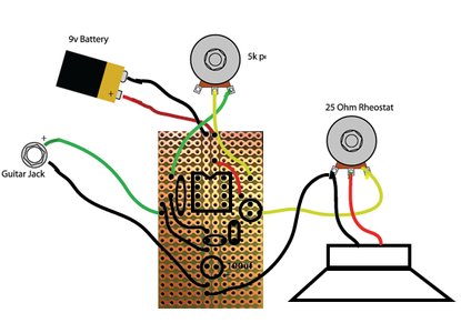

First and foremost, my proto-board from Mouser was different than the board shown at Make Magazine. The traces on the sides continued all the way to the end. So I had to move items to avoid having them just shorted out. The combination of the schematic and the image I created should clear things up. (I hope.)
At this point, you can decide if you want to use the 25ohm Rheostat. I think it's kind of redundant. The guitar has a volume knob, the potentiometer is a gain for the amp. It's your choice. You can just jump past it and wire the output of the 200uf capacitor to the speaker. I'll leave it for now, but I bought enough to do another amp, I may skip it next time. If you keep it, it gives you more control.

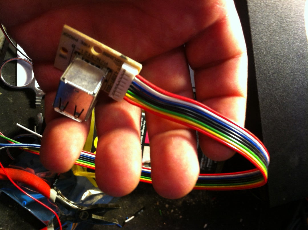

Oh as a side note, I used scrap wire from an old computer. The USB cable had colored wire, so I just used that to keep things looking neat. Yellow there, white there, etc.

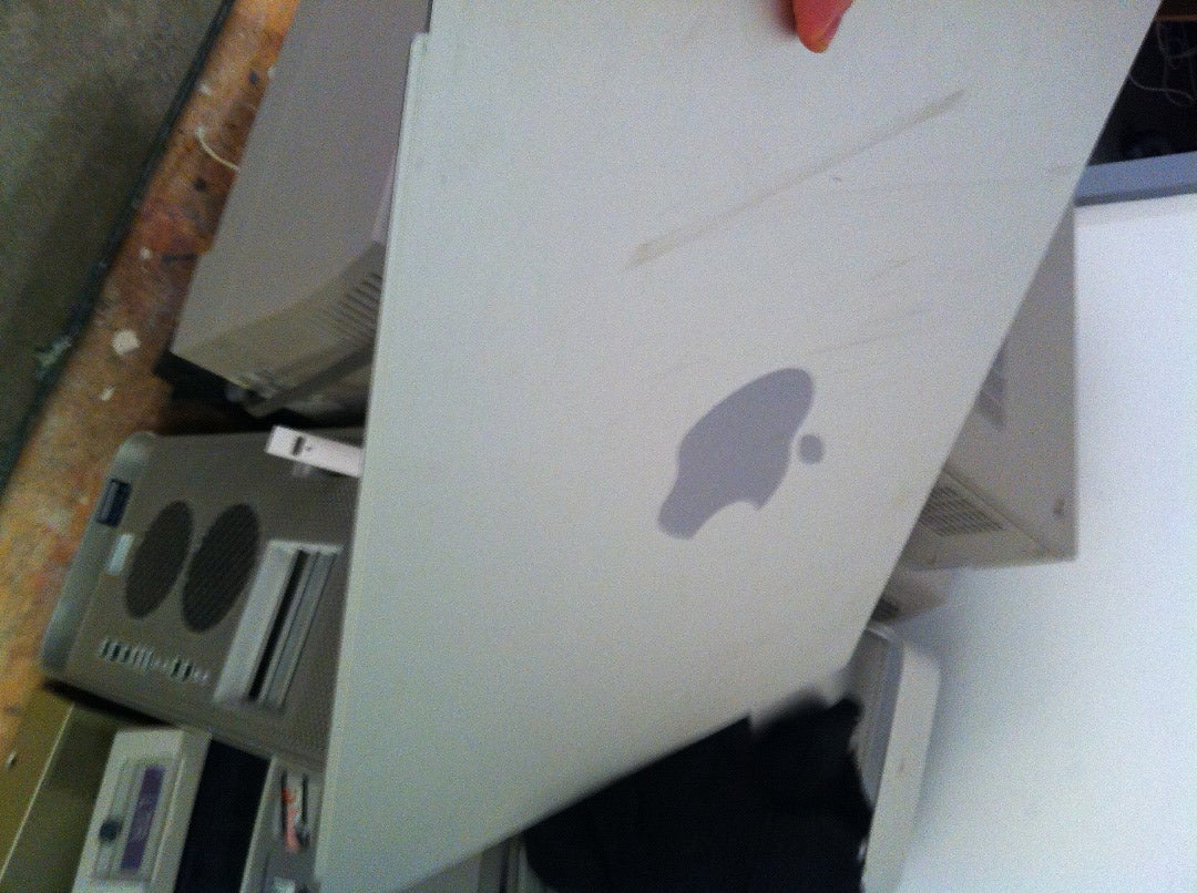

Mac's are wonderful machines, and so recycle-able! The side panel is a thick chunk of aluminum. OFF TO THE SAW!
I cut out a 5"x2" piece, drilled some holes then sanded it on the belt sander. I think it would look better on front here. (that's just me. You do what you want.)

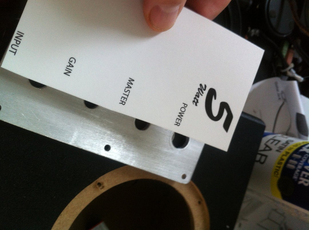

Step 6: Step 6: Refining the Control Panel

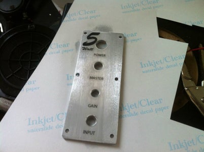

I have a step drill bit. These things are great for panel work, I sized the holes perfectly for each switch, potentiometer, rheostat and jack.
I've been experimenting with these print decal labels. I create some text in Illustrator, print it on a color printer, seal it with some clear acrylic spray paint then apply them to a panel.
Then several coats of clear acrylic to really secure them in place. I let the paint dry, gave it a light sanding to take down some high points with some 600 grit sandpaper then a final coat of clear.

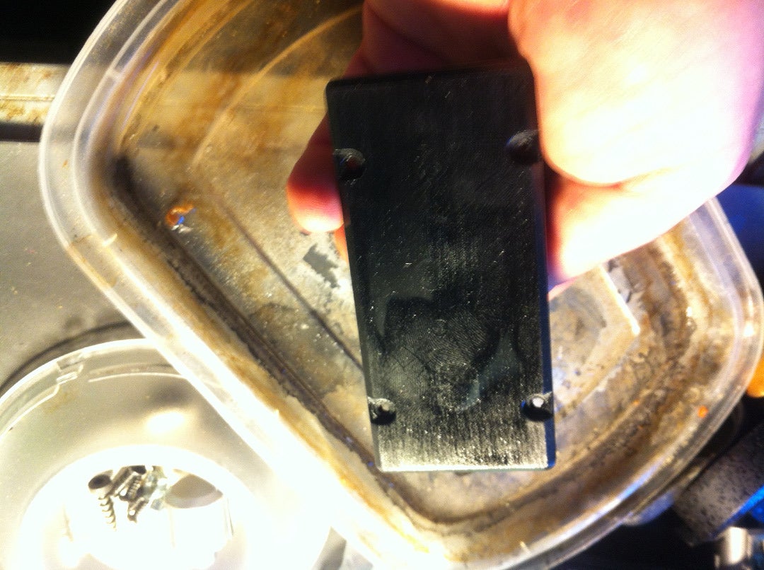

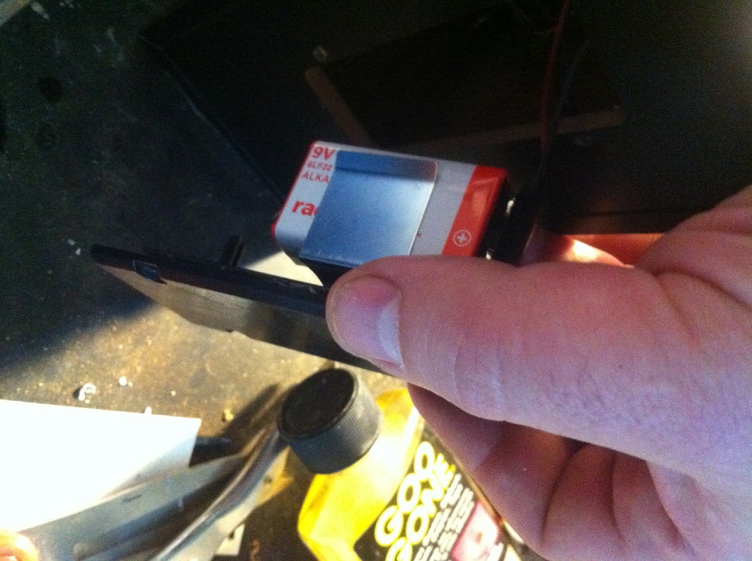

The clip from Radio Shack to hold the 9v battery is behind the plastic piece where the original controls were for the subwoofer and speaker system. I used JB weld epoxy to fill the holes, let it dry, then touched it up on the belt sander and gave it a coat of black paint. It's 4 screws to replace the battery, but that isn't THAT big a deal. I could have popped for a fancy case/holder system but I didn't want to spend a lot. (I already spend $$ on that darn handle!)
