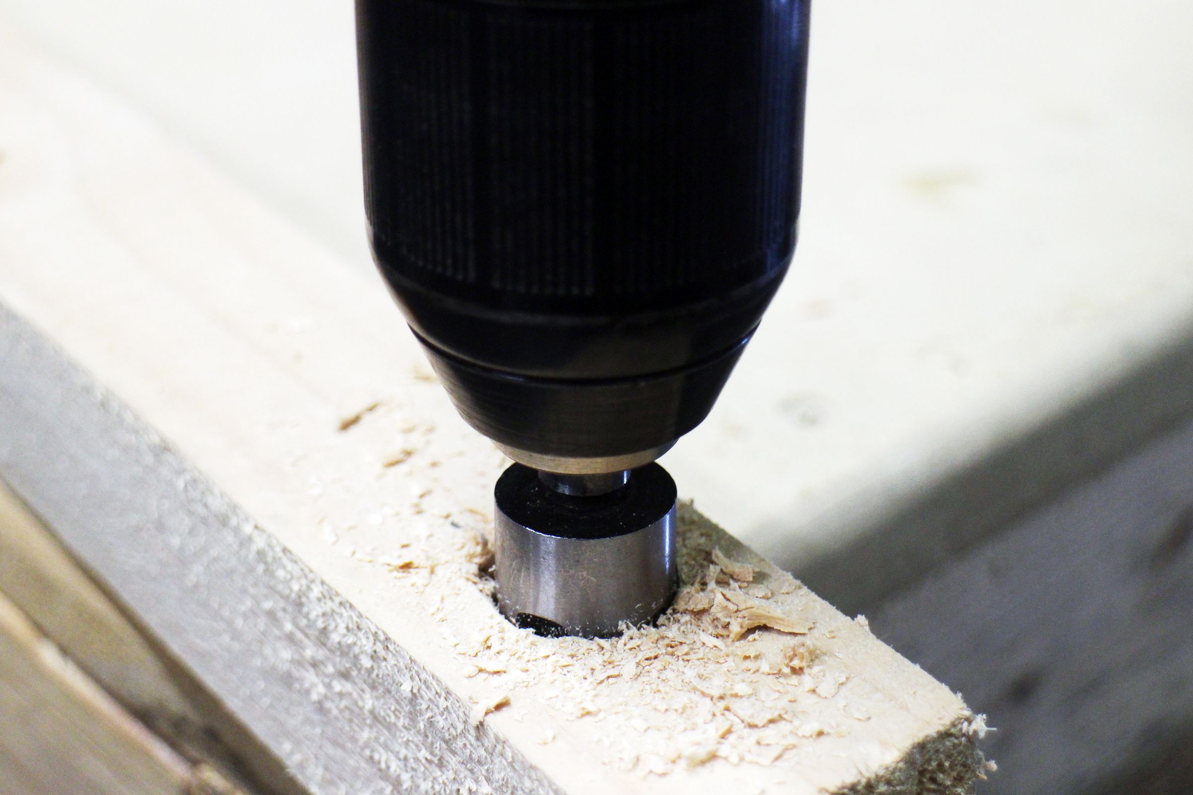

Step 5: Wood Plug Cutter
If the stripped screw is really deep inside your material and no other options seem to work then it's time to get really destructive. Wood plug cutters can be used to remove material from around the deep set screw and allow you access to an otherwise unreachable screw.
Place the plug cutter in an electric drill and position above the screw. Engage the plug cutter with the wood and remove material from above and around the stripped screw until the plug cutter has reached the screw head depth.
Remove the plug cutter and any debris it created and see if you can get access to the screw head for removal.
