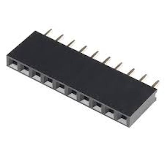

Female pins

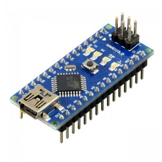

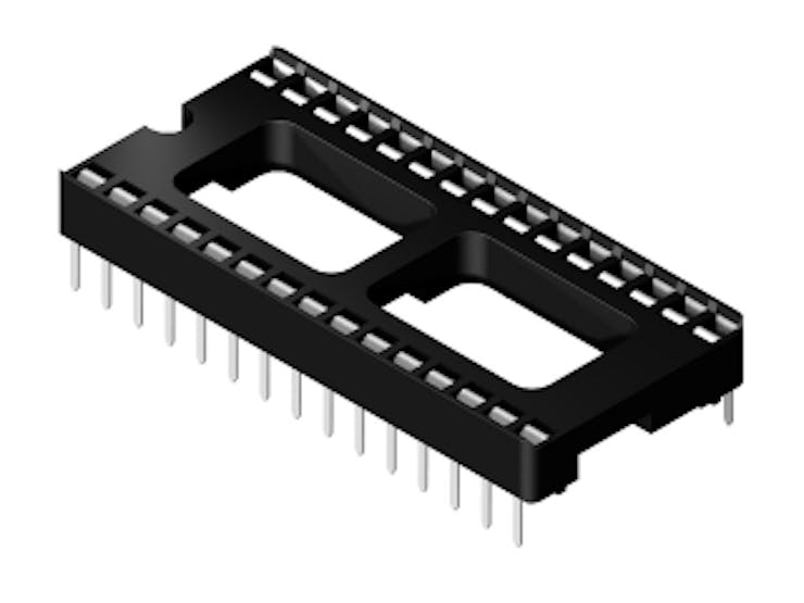

Socket for arduino nano

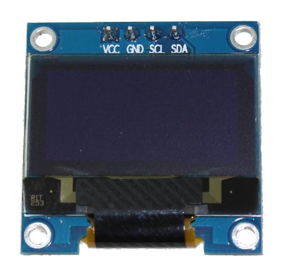

sh1106 oled display
It is a 128x64 dot monochrome OLED display module with I2C interface. It has several advantages compared to LCD screens, and we can highlight its high brightness, very good contrast, a wider viewing angle, and low consumption. of energy. It is compatible with Arduino Rasberry Pi and PIC microcontrollers among others. It works with logic levels from 3.3V to 5V and has a viewing angle greater than 160 degrees. Screen Size is 1.3 inches. It is powered with a voltage of 3.3V to 5V. It can be used in applications such as smart watches, MP3s, thermometers, instruments, and various projects, etc.

Characteristics
  • Interface: I2C(3.3V / 5V logic level)
  • Resolution: 128 x 64
  • Angle of view: >160 degree
  • Display color: Blue
  • Display size: 1.3 inch
  • Driver IC: SH1106
  • Power supply: DC 3.3V~5V
  • Operating temperature: -20~70'C
  • Application: smart watch, MP3, thermometer, instruments, DIY projects, etc.

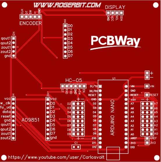

PCB
Download gerber file –> PCB
