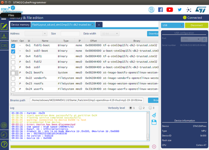

Step 7: Flashing the Controller
This step turned out to be the trickiest part up to this point. I will summarise briefly some of the grief I encountered with this as a cathartic exercise but feel free to skip over the next few paragraphs and proceed on a happier path by following the instructions on the FFBeast docs instead and maybe check back here if you hit a snag.
I wanted to test the electronics using the ODrive tools before flashing the controller board.
At first I tried to avoid installing the ODrive toolchain on my dedicated but elderly gaming PC which is the only Windows machine I own. I tried Debian Linux via Crouton on a Chromebook which had USB driver issues and Arch Linux on my Steam Deck which has a read only system partition that I needed write access to.
I even tried Window Subsystem for Linux (WSL) on Windows so as to at least avoid tampering with the host OS but had similar USB driver issues there. Likely these issues could individually be resolved but they all involved either making environment modifications that I was not entirely happy with or going down into some rabbit shaped holes. I expect that a vanilla Linux install would have fared better and briefly considered a Linux USB boot stick.
At this point I was running out of patience though so I threw caution to the wind and went straight to flashing the controller with the FFBeast firmware using STM32CubeProgrammer directly installed on my Windows gaming PC as per the FFBeast instructions.
This also turned out to be problematic as the programmer could not see the board initially.
At first I thought it wasn't going into DFU (Device Firmware Upgrade) mode but after reading through the FFBeast Discord and retrying many (many) times as suggested I tried using Zadig as also recommended to check the installed drivers.
As it turns out, a previous driver (from the C5 or perhaps a previous Thrustmaster wheel) was associated with the "STM Bootloader" device that the controller reports as in Windows Device Manager when in DFU mode.
I then tried using Zadig to swap the driver to something that the board programmer could work with. Luckily the first driver option that Zadig offered did the trick and the programmer software was finally able to see the controller board and flash it with the FFBeast firmware following the instructions in the FFBeast docs. Phew!
After flashing the controller I found I was no longer able to flash my C5 wheel firmware using the Cammus desktop software but I managed to fix that by changing the STM Bootloader device driver back to the one provided by Cammus using Zadig.

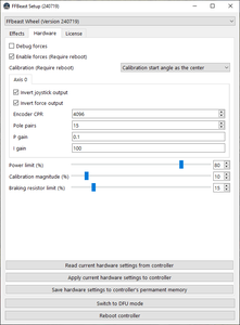

Step 8: Calibration and Testing
Once the firmware was loaded I could successfully run the FFbeast setup application from the website and begin testing using the FFBeast recommended test apps.
This involved setting the configuration of the motor (15 poles) and the encoder (4096 cpr) as per FFBeast guidelines as well as activating the firmware license and setting the FFB parameters - strength, rotation (540) and damping (10%).
I also set the brake resistor relatively high initially (50%) to protect the PSU.
When these settings were applied and saved to the controller board on the wheel base it was then rebooted to the latest settings.
I did the initial testing with low strength and no wheel attached. On the first run the wheel apparently calibrated ok but when I turned it by hand it started rotating to the right continuously.
I suspected either motor wiring or encoder issues. Turns out I was right on both counts.
I had followed the example from the document supplied with the controller board which had the motor power wires in the order - yellow, green, blue. After going through some examples on the FFBeast discord I found that some had a different order - green, yellow, blue which I tried. This seemed to address the runaway motor issue.
Note: As stated in the FFBdocs - don't follow wire colour coding. Always check the component schematics for the correct routing. In the case of the motor power wires, some experimentation may be required.
After getting the motor power wire order sorted and solving the runaway motor issue I was still having problems so I checked the VKB joytester program recommended in the FBeast docs and found that my encoder signal was periodically resetting to zero as I turned the wheel. Back to FFBeast discord for more research.
As it tuns out the Z wire in the magnetic ABZ encoder is being used by the firmware as a reset so I simply cut that wire and the problem was solved.
In hindsight, I should have set the motor strength to zero for the initial testing to get the encoder set up properly first. When this is working correctly the Joystick tester program shows the axis slider moving smoothly between both extents as you turn the wheel through its full range of motion.
At this point I attached my lightest steering wheel to the wheel base and started testing in Assetto Corsa while keeping a close eye on the electronics temperatures in case something was overloading.
From here I gradually increased power and reduced the percentage of brake resistor which I noticed was heating up at the higher values.
I initially settled at 80% power and 10% brake resistor which seems to give a great response on the wheel with crisp and strong feedback comparable but notably stronger than my already quite powerful Cammus C5 wheel.
However after further testing with a heavier steering rack car I found my power supply shut down due to overload protection so I backed this off to 70% with 15% brake.
Likely I need a beefier power supply to get the most out of the wheel base.
