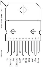

Step 2: TDA7265:
The TDA series of IC’s are very popular for their high-fidelity sound and super quite operations. There will be no humming or external noise if this IC is paired with proper external components. I am using TDA7265 which is a stereo IC, give the extreme output of 25watts per channel. TDA series need a very fewer external components too. But these class AB amplifiers are also need a cooling system. In most of the cases heatsink can do the job without any active cooling(fan).

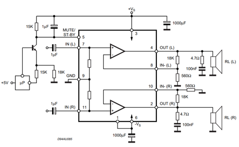

Step 4: Circuit Diagram:
I found this circuit in datasheet and this is real application circuit. Then I made my own with to understand it better. This IC is of 50watts, either we use 25watts for two channel for stereo operation or 50watts in bridge mode. The circuits for bridge mode is available here.

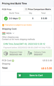

My circuit is complete but I want to give professional look to my project. So I designed the PCB to make the form factor as small as possible. A big shoutout to PCBWAY to sponsor this project. I upload my designs on PCBWAY.com offering best service in low prices. Ordering process is quite simple.
Step 6: Ordering Process:
Go to PCBWay > Fill the size of board > choose color and finishing > save it to cart > upload the Gerber files > checkout and make payment.
Mt special link for Sign-up is here, if you register using this PCB discount coupons will be credited into your account. Enjoy the service of 5 professional looking PCBs just in $5 with PCBway.

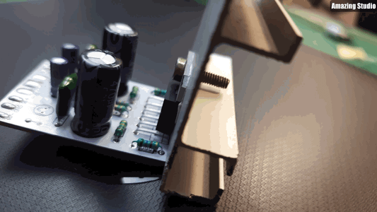

Step 9: Mounting Heatsink:
Usually the heat sink, is depend on the area and thickness of aluminum. I am using a big 100mm heatsink with this single IC of thickness 2mm. The most important thing is that there should be no any space lest between the heatsink and IC. To transfer heat immediately from ic to heatsink, we need heatsink compound. Improper placement of heatsink will immediately burn the IC and components.
If you have a short heatsink then an external fan is needed to keep the system cool.
