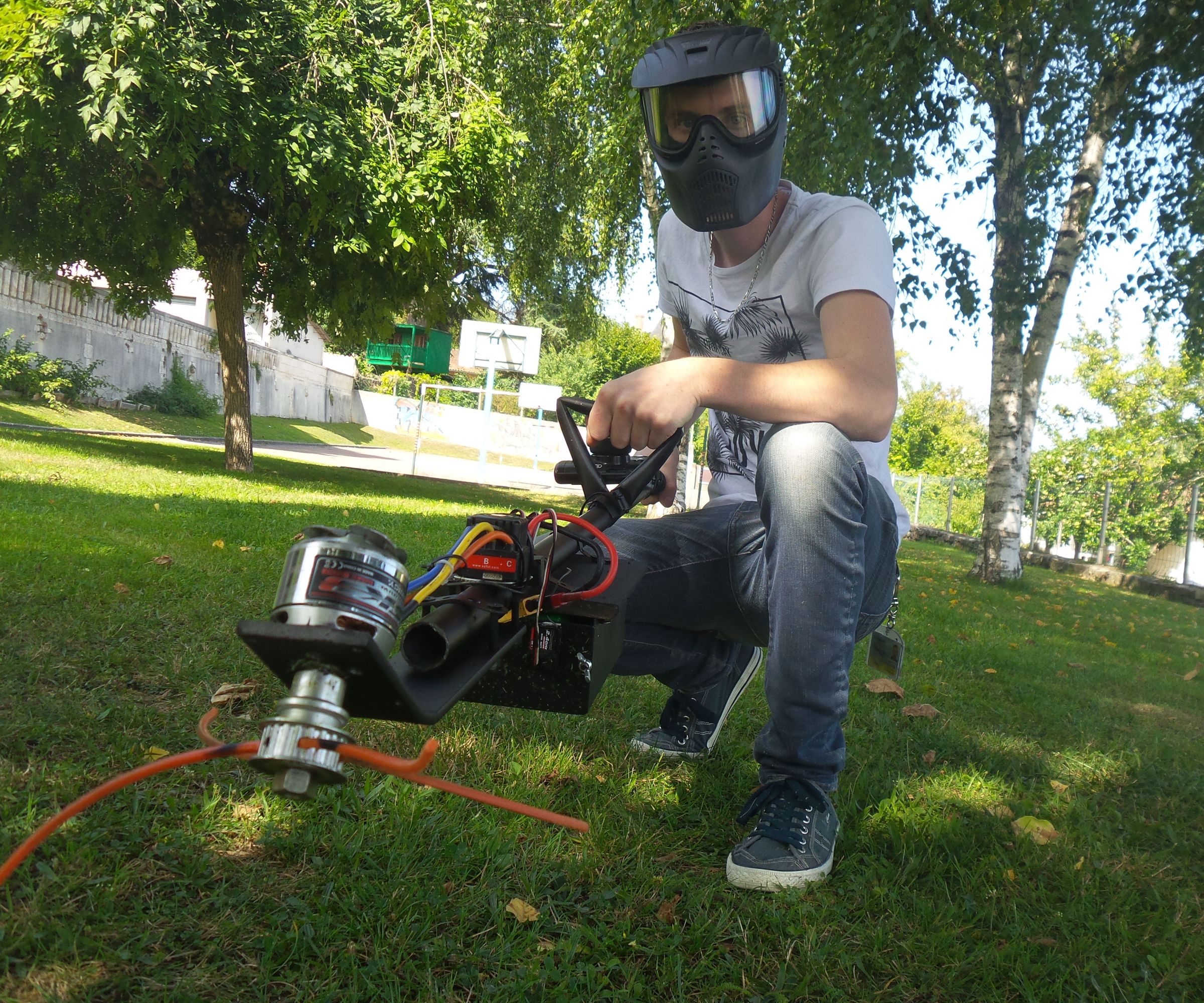

4 To make a plate to fix the engine to the truck and position the engine of way has to have the tense belt. Use one screw of 8mm and 2 bearing of skateboard to tense the belt .
5 To make one steel battery box with a grinder and a welding machine big enought to put the battery, foam of protection and the radio receiver. Make a door on hinge to reach the battery and load it. To weld slices there to fix it with screws has wood .
6 Fix the esc with a wide collring ands crews has wood outside the box for the cooling
7 To make a ventilator in a plate of steel 0.5 mm in thickness of the shape of the engine, it comes to settle behind the engine with 3 screw. In turning point, makes the air circulate. This ventilator is very important for cooling the engine, otherwise, it risks to burn out

The engine warmed a little too much, thus I added a ventilator, it is essential, otherwise the engine roasts and the controller also.
