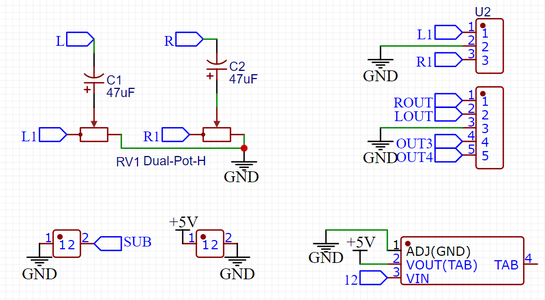

Step 4: Circuit Diagram:
Circuit is perfect for a 2.1 amplifier system, I only added the subwoofer bass option, but in future I will try to add some more features like frequency control, subwoofer volume control, treble control and mid adjustments. Here are using a small 5volt voltage regulator to power the Bluetooth board.
Always used polyester film capacitors instead of ceramic capacitors for good frequency response and low noise. In last, I made a suitable circuit for proper filtration and rectification of linear power supply.

Step 7: PCB Specs:
Our PCB has Onboard power supply, 4 channel speaker audio outputs and 1 subwoofer output, 5volt supply for the small Bluetooth system, Subwoofer and volume control presets, Desirable gain output for the speakers.
Step 8: Working and Observations:
High frequency has a little more gain over bass, so the lm324 can be modified to give lower gain by changing this resistor here. If you want to know more about OP-amp workings as buffer then read this article. The bass gives a very high punch which can easily drive a subwoofer of 12inches. The sound is very loud while I am testing this with TDA7294 subwoofer amplifier and TDA7265 speaker amplifier. Both of the amplifier is classified in class AB and known for their high-performance high-fidelity output.
