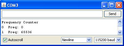

To test the circuit you need a frequency counter or a ossiloscope you cannot just hear the sound and make out that if the circuit is working or not as the sound produced of high frequency and you cannot hear it . I did not have any frequency counter on hand so I made a quick and easy frequency counter using the arduino you can find it here . Here are some screenshots of the frequencies that the circuit produces.
