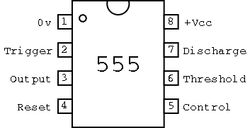

PINS
Pin 1 (GROUND) - The ground (or common) pin is the most-negative supply potential of the device, which is normally connected to circuit common when operated from positive supply voltages.
Pin 2 (Trigger) - This pin is the input which causes the output to go high and begin the timing cycle. Triggering occurs when the trigger input moves from a voltage above 2/3 of the supply voltage to a voltage below 1/3 of the supply. For example using a 12 volt supply, the trigger input voltage must start from above 8 volts and move down to a voltage below 4 volts to begin the timing cycle. The action is level sensitive and the trigger voltage may move very slowly. To avoid retriggering, the trigger voltage must return to a voltage above 1/3 of the supply before the end of the timing cycle in the monostable mode. Trigger input current is about 0.5 microamps.
Pin 3 (Output) - The output pin of the 555 moves to a high level of 1.7 volts less than the supply voltage when the timing cycle begins. The output returns to a low level near 0 at the end of the cycle. Maximum current from the output at either low or high levels is approximately 200 mA.
Pin 4 (Reset) - A low logic level on this pin resets the timer and returns the ouput to a low state. It is normally connected to the + supply line if not used.
Pin 5 (Control) - This pin allows changing the triggering and threshold voltages by applying an external voltage. When the timer is operating in the astable or oscillating mode, this input could be used to alter or frequency modulate the output. If not in use, it is recommended installing a small capacitor from pin 5 to ground to avoid possible false or erratic triggering from noise effects.
Pin 6 (Threshold) - Pin 6 is used to reset the latch and cause the output to go low. Reset occurs when the voltage on this pin moves from a voltage below 1/3 of the supply to a voltage above 2/3 of the supply. The action is level sensitive and can move slowly similar to the trigger voltage.
Pin 7 (Discharge) - This pin is an open collector output which is in phase with the main output on pin 3 and has similar current sinking capability.
Pin 8 (V +) - This is the positive supply voltage terminal of the 555 timer IC. Supply-voltage operating range is +4.5 volts (minimum) to +16 volts (maximum).

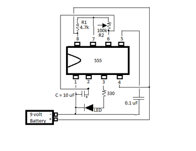

Step 5: Assembly: Connect the Battery Leads
Push the positive lead from the battery clip (red) to the positive row on the breadboard (red +). push the negative lead from the battery clup (black) to the negative row on the breadboard (blue -).
The run a jumper wire joining the top and bottom negative buses on the breadboard.
Step 6: Assembly: the Electrolytic Capacitor
Electrolytic capacitors are polarized, meaning the positive lead from the capacitor must be connected to the positive (high) voltage and the negative lead of the capacitor must be connected to the negative (low) voltage. The negative lead of the electrolytic capacitor will be marked with a band of differing color and a "-" sign. Many times the longer lead of the electrolytic capacitor will be the positive one and the shorter lead will be negative. The schematic drawing of an electrolytic capacitor will be the same as a non polarized capacitor, but the polarity will be marked with a (+) sign.
Attach the capacitor so that the positive lead is on the same column as pin2 of the 555 timer and the negative lead is on the same column as pin1 of the 555 timer.
Attach a short jumper cable from pin1 of the 555 timer to the negative (ground) bus on the bread board.
Step 7: Assebly: LED and Resistor
Place the LED in an arbitrary location on the breadboard (not in any columns that are connected to the 555 timer pins). Make sure that the negative lead of the LED (shorter lead) is connected to the negative bus on the breadboard and the positive LED is on a column of its own.
Next, attach the 330 ohm (Orange-Orange-Brown-Tolerance) resistor from pin3 of the 555 timer to the positive lead of the LED. Resistors have no polarity, so no need to worry about the orientation of your resistor.
Step 8: Assembly: Positive Voltage and the Ceramic Capacitor
Attach a jumper from pin4 of the 555 timer to the positive bus of the breadboard. This pin is not being used in our circuit, so we connect it to the positive voltage lead.
Ceramic Capacitor
Unlike electrolytic capacitors, ceramic capacitors are unpolarized, meaning they do not have a positive and negative lead. Thus, we won't have to worry about which lead goes to the positive side and which lead goes to the negative side.
Attach one lead of the ceramic capacitor to pin5 of the 555 timer (top right pin) and the other lead to the negative bus on the breadboard.
Ceramic Capacitor
Step 9: Assembly: Pin6 and the Trim Pot
Attach a jumper cable, one end at pin 6 of the 555 timer, the other end at pin2 of the 555 timer.
Place the 100k potentiometer in an arbitrary spot on the breadboard (Place it on any columns of pins that aren't being used by another component, a corner is a good spot).
Step 10: Assembly: Wiring the Trim Pot
Run a jumper wire from pin6 of the 555 timer to the center of the trim pin of the trim pot.
Run another jumper wire from pin7 to the right most pin on the trim pot.
Step 11: Assembly: Final Resistor and the Power
Attach one lead of the 4.7k ohm resistor (yellow-purple-red-tolerance) to pin7 of the 555 timer and the other lead to pin 8 of the 555 timer.
Attach one end of a jumper cable to pin8 of the 555 timer and the other end of the jumper cable to the positive power bus on the bread board.
At this point, as long as everything is wired correctly, you should see the LED turn on. Don't be worried if your LED is not flashing at this point, there is probably a good reason if it isn't.

A basic trim potentiometer diagram is shown in the picture. Pins 1 and 3 represent ends of the variable resistor and pin 2 represents the wiper. To achieve a basic variable resistor, you attach the two leads of interest to either pin 1 and 2 or pin 2 and 3. The only difference between using pins 1 and 2 and using pins 2 and 3 is the direction that you turn the trim pot to give you 100k ohms or 0 ohms. When the leads are connected to pins 1 and 2 of the trim pot, the resistance between pins 1 and 2 will be 0 ohms when the adjustment knob is turned all the way counterclockwise. When the leads are connected to pins 2 and 3 of the trim pot, the resistance between pins 2 and 3 will be 100k ohms when the adjustment knob is turned all the way counterclockwise.
Adjustment
you can probably already tell that as we increase the resistance of our trim pot (which connected between pins 6 and 7; thresh hold and discharge), the frequency of the blinking LED is reduced. We can find a numerical representation of the on-off frequency of the LED given by the following expression.
Frequency = 1.44 / ((R1+2*R2)*C)
On Interval (in milliseconds) = .693*(R1+R2)*C
Off Interval (in milliseconds) = .693*R2*C
