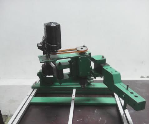

It all began when I purchased some TB6560 V20 stepper motor driver boards, for a 3 axis engraver that I am building, Two boards arrived with two broken switches, and, I wanted to know if the boards were functioning properly, the safest way was to develop a pulse circuit to drive the board, by using a 555 timer. the circuit was a success and I found that the Driver boards were functioning properly. When I informed the seller at Ebay he refunded 25% of the cost...
