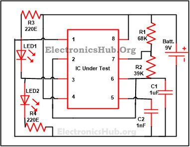

Here is the circuit diagram of 555 Timer IC Testing Circuit. This 555 IC Testing Circuit tests your entire 555 timer IC. So before using your IC, check immediately that your IC is good or bad by checking it. This can be done by checking the IC that it is oscillating or not. Or you can use this circuit in some other circuits also to troubleshoot the proper working of 555 IC.
