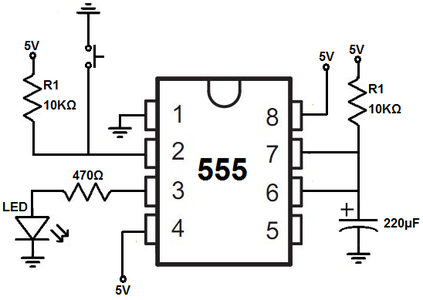

Start by placing the 555 timer ic into the breadboard.
Step 3: Resistors and Capacitor
Now add the resistors to pin 2 and positive and pin 7 and positive and the capacitor to pin 6 and GND.
Step 4: The LED
Next add the resistor to pin 3 and the positive of the led to the resistor and the negative to gnd of the board.
Step 5: Jumper Wires
Connect wires in this order-
Pin 1 to GND
Pin 4 to Positive
Pin 6 to Pin 7
Pin 8 to Positive
Step 6: The Switch
Lastly add switch and connect a wire from pin 2 to one side and a wire from GND to the other pin.
Step 7: Finished
Now hook up the battery to the board and press the button!
The LED should stay on for a short period of time then turn off!
