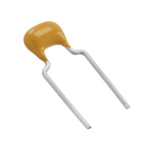

  • Capacitor: 10nF (Digikey)

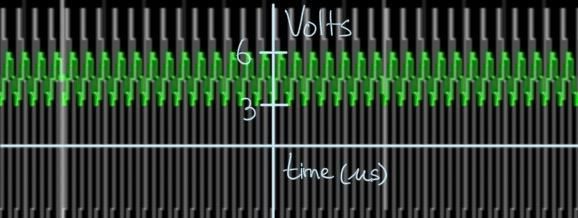

In this circuit, the capacitor initially has 0 Volts across it. This also means that the threshold pin and the trigger pin on the 555 timer are also zero. This means that the output on the 555 timer will be high. As a result, this voltage will start to increase slowly until the capacitor is at two thirds of the Vcc (2/3*9 volts). Once it has reached a voltage that is two thirds of the Vcc, then the comparator attached to threshold inside the 555 timer will flip, and the output will now be low. This means that the capacitor will start to discharge, and it will do so until it reaches a voltage of one third of the Vcc (1/3*9). Then the same process as earlier will repeat (except it will start at 1/3*Vcc now instead of 0 Volts.) It is this constant process being repeated that causes a frequency in the circuit. Now, this constant change also affects the transistor that causes the IR LED to light up. When the output is low from the capacitor, the IR LED is off, and when it is high, the IR LED is on.
Above are two graphs to help you understand this concept better (the green line is what we are looking at). The first is the capacitor at the frequency where it blocks the TV IR receiver. The second is at a much lower frequency, allowing the constant charging up and discharging to be seen more clearly.
In order to actually change the frequency in the circuit, you need to mess around with the potentiometer. The potentiometer is actually what affects how fast the capacitor is able to charge up, and then discharge. In order to achieve a very high frequency (such as 38 kHz), you need to have the resistance in the potentiometer very low (if you look at the above circuit diagram, you want #1 on the potentiometer to be as low as possible).
