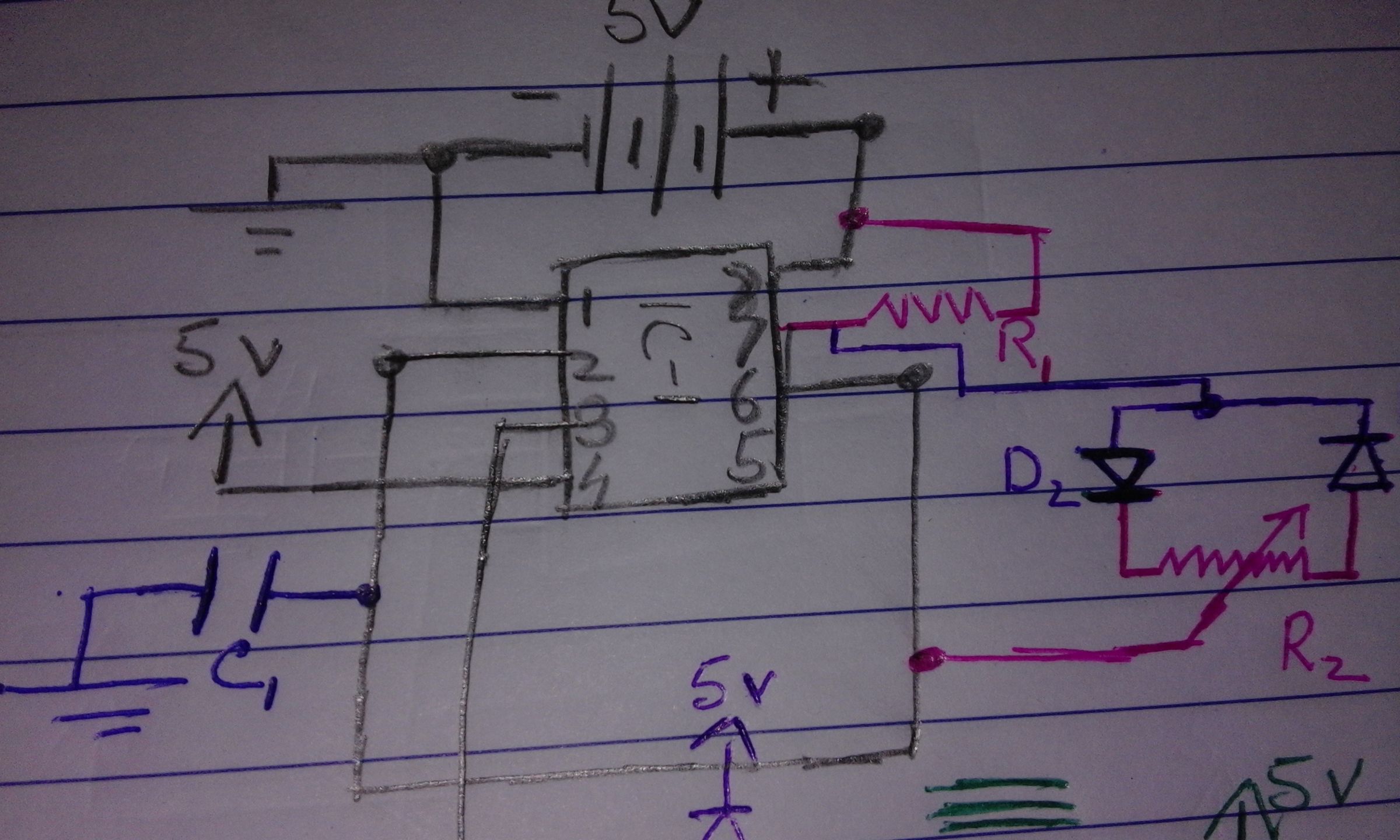

I've been trying to make a boost converter from a really long time. At first I thought it would be easy, tune a frequency , add inductors, fets, caps, and done. but it was really hard to make it. It boosted the voltage but when i attach any load it would drop. so i went online and learnt about inductors and it helped really good. if u have higher inductance then you will need lower frequency and the other way around. so i designed this circuit where the 555 timer is set in an a-stable mode and the frequency is set to 32 kHz and the pot is here to modify the pulse-width, which will control the voltage.
WARNING:- attach a load before powering it up, cuz the voltage exceeds 100v
if u guys know how to solve this problem, please let me know.

Step 2: Circuitry
The shemetic is given in the images.
It should work now. It needs minimum 5 volts and 200 mili amp. and I know its to much current on no load, but hey it works.
