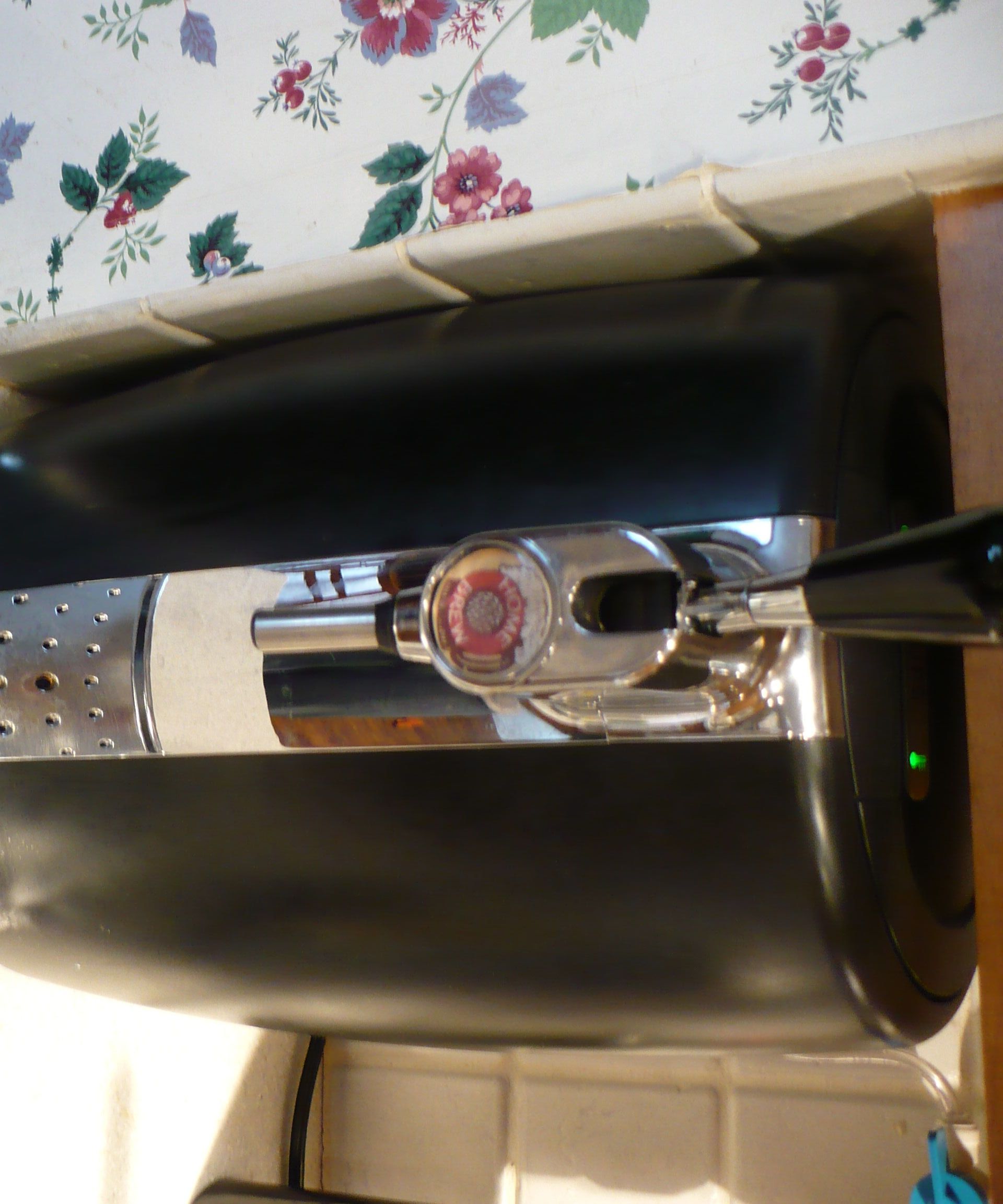

I have sitting on my counter the Krups Beertender I converted (https://www.instructables.com/id/Krups-Beerteender-Conversion/), but for the Superbowl I realized how non-portable this solution was. So I set out to find a easy and cheap portable tap that I could use from a cooler, counter top, or fridge.
After looking online, I found this: http://forum.northernbrewer.com/viewtopic.php?f=3&t=61167&sid=f054f78a221afd9740f0c31521c11bc4 , which really helped me with the basics and why not to use brass/copper. His design is pretty great, but I think I have been able to simplify and make it cheaper.
