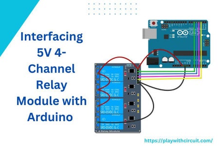

Introduction: 5V 4-Channel Relay Module With Arduino
About: I'm an avid Arduino and electronics enthusiast with a passion for tinkering, experimenting, and bringing innovative ideas to life.
Relays are essential components in electronic projects that allow low-power microcontrollers like Arduino to control high-power devices such as lights, fans, and appliances. A 5V 4-Channel Relay Module is a widely used interface that enables switching multiple AC or DC loads with ease.
In this tutorial, we will explore how to interface a 5V 4-Channel Relay Module with an Arduino. We will cover the relay module’s pinout, working principle, internal circuitry, and specifications, followed by a practical example to control LED and motor using Arduino.

Step 4: Interfacing Four-Channel Relay Module With Arduino
Now let us learn how to interface 4-Channel Relay module with Arduino.
Here, we will control a motor and an RGB LED. First, the motor will turn ON, and then the LED will cycle through different colors as its red, blue, and green anodes are connected to the supply one by one. Finally, the motor will stop, and the LED will turn OFF.
