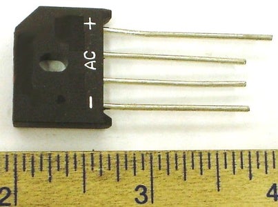

Full Wave Bridge rectifier (50V 4A) ($1.50)

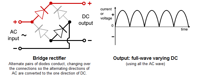

Connect the output of the transformer to the bridge rectifier, measure the output it wont measure a full 12V (the nature of the rectifier)
Also wrap the AC inputs in heat shrink.
Connect the regulator to your positive and base of the rectifier.
facing you left to right the regulator goes input, base, output
Attach the smoothing capacitor to the positive, and base. i'm not sure if this actually does anything in my circuit but the voltage comes out constant and it went under life test with no shorts or anything funky so i'm assuming it does work.

It works at a 5v output, cool right? I think it is.
I'm not sure how this will work if it shorts out, it may fry the transformer.
Input voltage: the wall
rectifier: 4A max
Output voltage: 5v regulated 1.5A
max current: limited by the rectifier, and regulator, multiple rectifiers and regulators can be used just as long as the wattage doesn't max out your transformer
Some sort of heat sink is going to be instituted, probably some glue or silicone coating the rectifier and regulator.
Anything special I should know about this like if it's incredibly dangerous? or maybe that my capacitor isn't doing anything.
