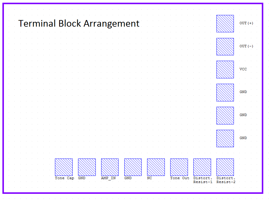

6. Terminal block map:
Terminal blocks are used as interface between front/back panels and soldered circuit board. Notice that not all the nets are present on the TB map: For example, power indicator nets are combined with back panel components, so there is only need to conduct VCC and GND nets from back panel to circuit board. Probably, the best way to arrange connections, is to make TB per each component, and complexity of assembling process would drop drastically.
(Bypass capacitors and output filter recommendations. are well described in the datasheet)

Speaker set: Because the output signal comes from the 1/4" female jack connector, I soldered 1/4" male jack to the speaker wires (See the image above).
After everything is completed, connect ALL the wires from back and front panel to the TBs of circuit board, adjust circuit board to the fixed position and close the device. After all the screws on the corners are fastened, we can officially declare that our project is finished.
