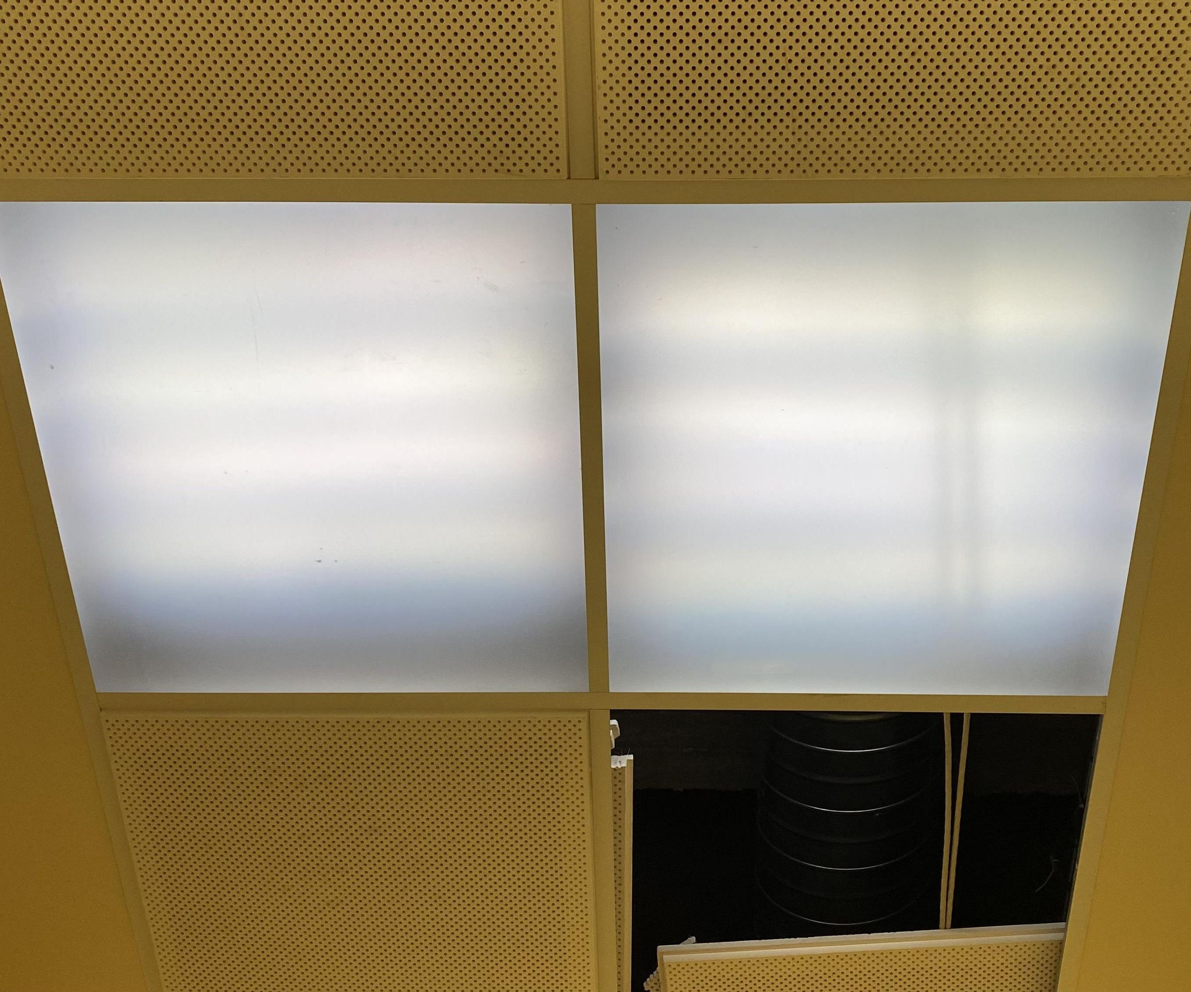

OGIV3 and D4LLE are both accessories for Helios Tubes.
The first, to be combined with a China Ball: Take a look
The second to be used into suspended ceillings: It's over there
