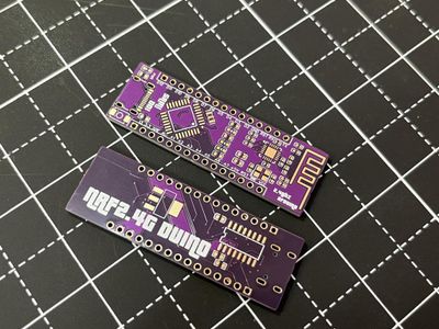

I made a 6 layer Arduino board which has integrated NRF24L01 radio module. It comes in a small form factor of NANO.

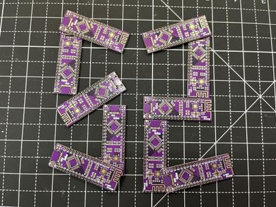

This Arduino designed is dedicated from the existing ones on the Chinese websites and they are selling them for $40 per piece. But my designed Arduino is very cheaper than that. You can get the PCBs just in $50-60 for 10 pieces of the same board including stencil. Here I don’t have QFN package of Atmega328p that’s why the tracks are very separated to each other and I have to use 6 layers for it.

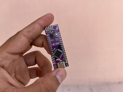

I built a NRF24l01 module for the testing first to know the real schematics of the radio module and then implemented the same on other big form factor board. But keeping the breadboard use in mind this time the form factor is designed same as the NANO. PCB antenna is embedded at one side of the PCB. The microcontroller is made to work independent and can be changed to NRF mode using software chip enable instructions.

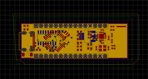

First, I tried to compress the joints and connection in a dual layer board under the JLCPCB capabilities. But due to the big SMD package of ATMEGA328P it is not possible. The QFN package of Arduino chip is not available to me right now. That’s why the PCB got 6 layers if you want to use the same PCB for your design then download the Gerber files from here.

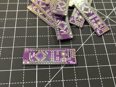

I received these amazing 6-layer purple color ENIG finishing PCBs from JLCPCB just in 7 days after manufacturing. Sign-up to JLCPCB using this link and get $54 new user coupon for the next PCB, SMT orders.

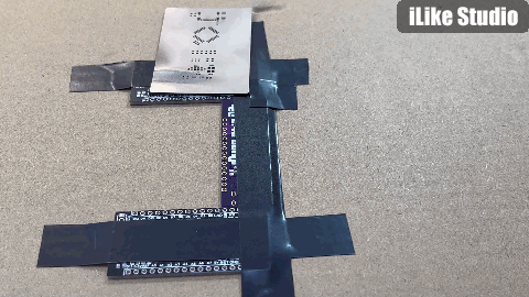

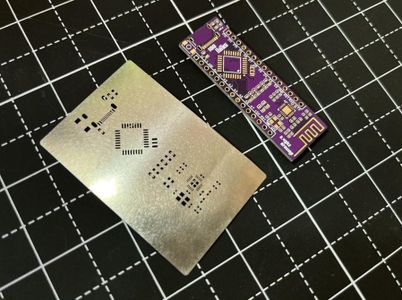

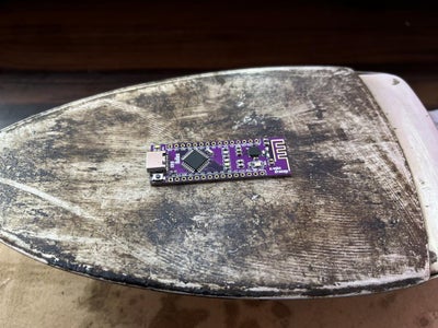

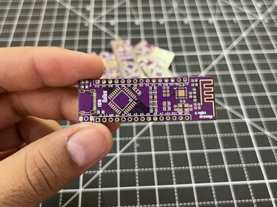

I used SMT stencil service from JLCPCB it will cover a thin uniform layer of soldering paste over the PCB. Then place the parts on the PCB gently, solder using the hot plate or hot air gun. Stencil can be used multiple times using the proper housing. It can be taped using the same PCB housing from 3 sides and PCBs can be inserted from then other side.
Step 5: First Look and Testing:

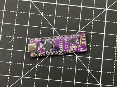

The purple solder mask layer is very good, you need to repair some soldering joints because of uneven temperature curve of solder heater. Nrf24l01 module is embedded at one side which makes it to use independent. After that I will test the microcontroller continuity and then power it up and check the power consumption of the total board.

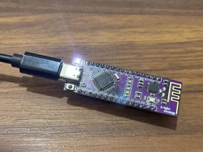

Step 6: Programming:
After burning the bootloader, it is always recommended to go with the simplest blink code it will help to check the software and hardware problems. You can see the Arduino bootloader tutorial from here.
Step 7: Troubleshooting:
The main problem is to solder the type C USB on the PCB because of its small connection points. Power and data lines are connected to the PCB via this port and any cross connection can damage the whole chip in this case.
Test the power and data lines without powering the MCU and check for the continuity.
After powering up check the power led and then go for the bootloader. If there is any problem in bootloader burning then there might be some soldering mistake at CH340C or Atmega328p.
