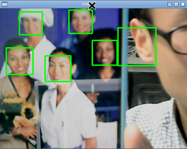

I use my mobile phone to show a picture with many faces, the detection result is not bad, although it shows that there are six faces, only five faces are true. Please check the following picture.
