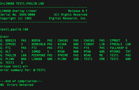

Step 3: Sample Compile a Program
Fortunately the distribution files contain a TEST1.PAS program, a very simple pascal program, this is the file:

As you can see, it's very simple. So to compile it type:
G>mt68 test1

Now it's time to link the program into a .68k executable
G>link68 test1,paslib.l68
LINK68 Overlay Linker                  Release 0.f
Serial No. XXXX-0000           All Rights Reserved
Copyright (c) 1983          Digital Research, Inc.
test1,paslib.l68 <br>
You should not get any errors, the end result is a file called test1.68k. This can be run directly by typing:
